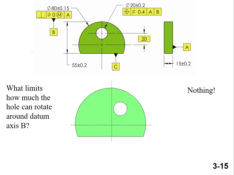

A couple of helpful images were included by Chez 311 in the thread above from 2018.
A did fairly extensive searching in ASME Y14.5-2018 for combinations of "datums", and "not referenced" but struck out.
Does anyone know where those images, or images like them, might have come from?
Also if non referenced datums are discussed in some version of ASME Y14.5 ?

I don't think I heard before about non referenced datum.
You might use them if a general note such as "Unless otherwise specified (UOS) all features are within profile|xxx|A|B|" is shown on your drawing.
Probably some instructional book for a course. AFAIK "not referenced" has never been discussed.
This seems more like would come from a training company that had instructors that HAVE HAD IT UP TO HERE with being shown examples of how companies and individuals believe it is supposed to work.
Agree, looks like illustration from textbook saying: "This is wrong and that is right"

In looking at Y14.5-2018, the closest thing that I can find is in paragraph 6.3.2, where they mention (a couple of times) that a datum feature "requiring identification" shall be labeled etc.
So if a datum letter isn't utilized in a feature control frame (or a special note) then -- to me -- it doesn't "require identification" and thus it shouldn't be on the drawing.
I admit that might be a flimsy case, but oh well.
Here's a snip from the Tec-ease course. This was an actual argument I had with an inspector back around 2006 or so. He insisted that datum feature reference was implied if datum features were identified, even if they weren't in the datum reference frame. This is actually what the part looked like. Usually the question is "Why is the datum feature identified if it's not used in a datum reference frame?" The answer is "I don't know. That still doesn't mean its use is implied."

I agree with you John, but if the drawing is having a general note such as ""Unless otherwise specified (UOS) all features are within profile|xxx|A|B|" " THEN your answer "NOTHING" is probably not correct anyomore.
In the latter case, maybe the answer will be "SOMETHING".
For that Tec-ease snippet, couldn't you customize the datum reference frame, and use datum feature C only to control rotation?
So the callout could be something like A [x, u, v] | B [y, z] | C [w]?
That would appear to honor the intent of the position tolerance, and actually reference C appropriately.

But it doesn't have that note, nor did the original drawing, so the answer is still "NOTHING". Why even go down this road of trying to find something wrong with the lesson being conveyed?
First of all A could never constrain translation along x and B could never constrain translation along z even in a customized DRF, assuming x is horizontal in the main front view. Second, in the DRF in the drawing that I showed, all C could do is constrain rotation around z if it was tertiary and that's actually what's missing here.
John Acosta, GDTP Senior Level
u = rotation about x, v = rotation about y, w = rotation about z
x and u should not be together. Swap "u" with "w".

If x was out of the page for the main face and y and z were in the main face, then the rest would be OK.
An academic argument could be made that a complex feature controlling all degrees of freedom with one released could have x and u as references - but that gets back to "show a manufactured mechanism, available for sale" where that is a reasonable control to make.
