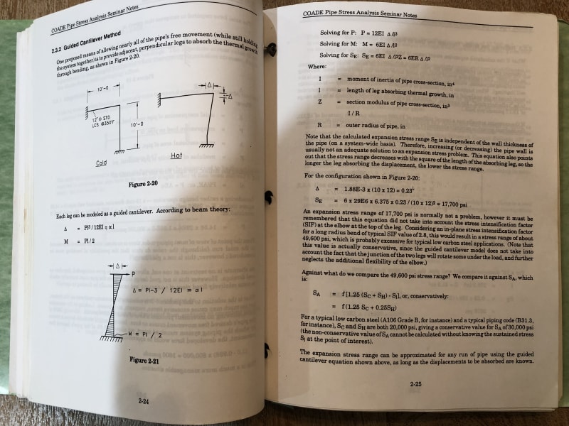

The ASHRAE calculation method you show is called the Guided Cantilever Beam Method which gives a very very conservative value for stress in pipe due to thermal expansion.
In the gudided beam method the thermal deflection of a given run piping is assumed to be absorbed by the offset leg of the connecting piping. Where the offset leg of the connecting piping is assumed to act like a guided cantilever beam. A guided cantilever beam is a beam that is totally fixed at one end, and at the other end (the one that moves with the thermal expansion) can move laterally in the direction of thermal expansion, but cannot rotate. This beam type is listed in most tables of beam found in any mechanics of materials textbook. If you think about it, this is how the offset piping mostly moves when deflected but the expansion of the long run, since it is restricted from moving totally by the connecing downstream piping at the far end, but at the near end point of connection to the thermal expanding pipe it moves but does not rotate. To some extent this is true but there is some rotation of the ends but this is neglected for this analysis method.
For a guided cantilever beam experiencing deflection at one end that does not rotate with other end fixed, the moment is calculated to be:
M = 6EI(Delta)/L2
Since Stress S = Mc/I
then substituting M into the S equation
S = 6EI(Delta)/L2 * (c)/I
Since I cancels and c = D/2 the this reduces to
S = 6E(Delta)/L2 * (D/2)
S= 3E(Delta)(D)/L2
And rearranging:
L = SQRT ((3E(Delta)(D))/S) which is the AHRAE equation above.
For a Z bend thermal expansion of the lenght of the long straight run between the two short runs will be taken up equally by the short runs so in the above equation Delta = total thermal exapansion divided by two, but the same equation is used.

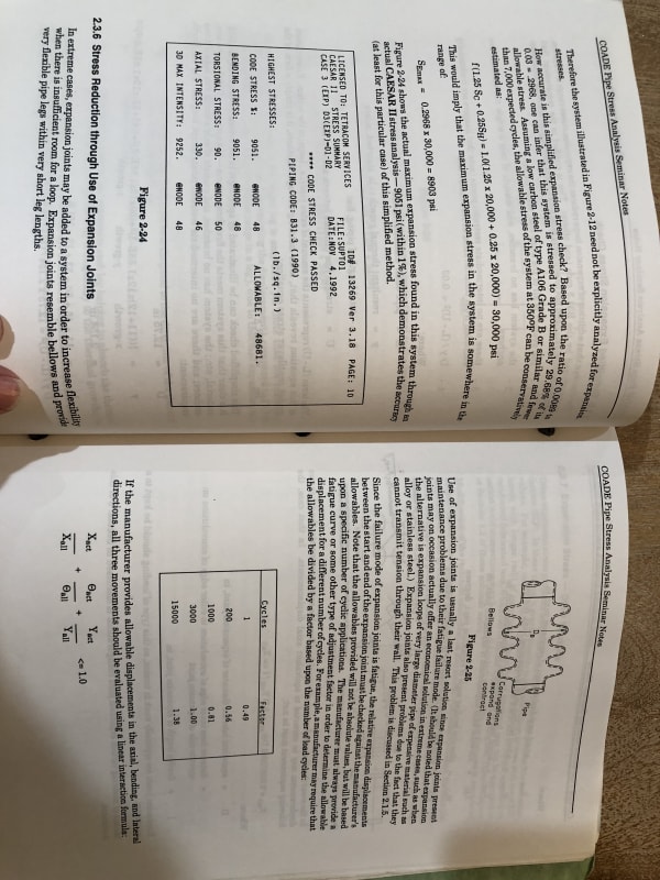

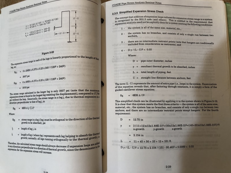

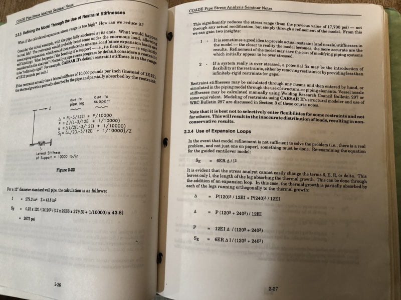

I have a good reference from a Caesar seminar that I will post later today and maybe an old excel spreadsheet calculation I developed if I can find it.
Here is pages of Caesar manual which goes over manual piping stress analysis using the guided cantilever method. Note that in their calculations they include a stress intensity factor for fittings such as elbows.
Helpful hint - place a black sheet behind scanned or photographed book pages to eliminate bleed-through of the reverse text.
