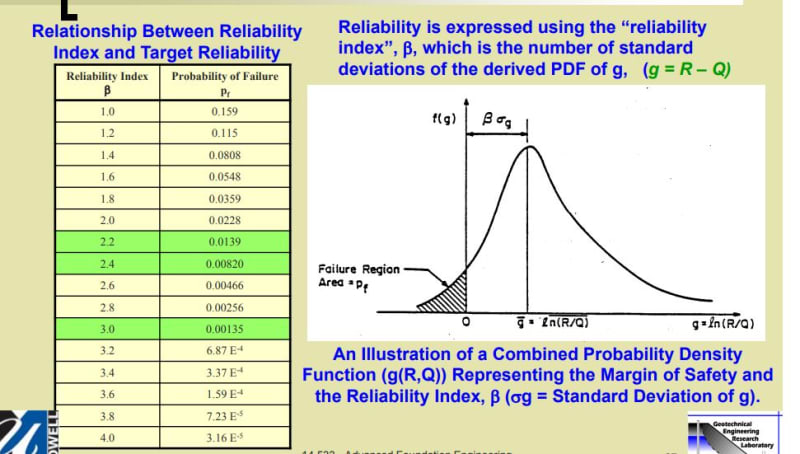

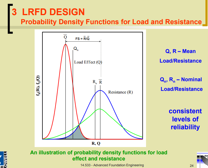

Seems to me that the heart of this question is related to design methodology. In the US we use LRFD and ASD design approaches. The load combination factors, and strength adjustment factors are calibrated using a statistical approach to provide consistent levels of reliability.
OP could look into this further. Link

@ Drifgtl imiter . I checked the PDF, I think yes, this is the one that I was looking for. DO you have any other examples or Ref. from there I can learn how to calculate these value.
@kamal
Unfortunately I do not. As mentioned by others on this thread, this is something that researchers have developed over the years, and many engineers don't know the specifics of it (me included).
But I think if you research the history of LRFD for example you will be in the right subject matter.
