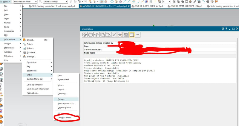

I have a ThinkPad workstation laptop (P50s) with an Nvidia GPU (Quadro M500M) and its standard Intel integrated GPU. I'm running NX11.
PROBLEM: I was modeling a structural frame and as soon as I added some hardware (nuts & bolts), the shading/surfacing went... I don't know what it is called, but the shaded surfaces aren't uniform. They are jagged and mix up nearby colors with nearby parts as if parts are overlapped, but they aren't (i.e. It's just one part.). Then I noticed the rest of the frame structure now also exhibits the issue. The file is not large (i.e. Only ~4Mb.).

In the Nvidia control panel -> manage 3D settings, the information icon is telling you that the Windows OS is controlling the selection of the graphics processor. On the same screen, there is a "program settings" tab; open that and you will be able to set NX to always use the Nvidia processor. Alternately, you could make the Nvidia processor the global default, but that would probably need to be done in the Windows settings. Note that the integrated graphics chips are usually less power hungry. If you often use your laptop on battery power, you might want to only use NX on the Nvidia processor and use the integrated graphics for everything else.
www.nxjournaling.com
Verify NX is using your better graphics card
Take it out of perspective view mode.
