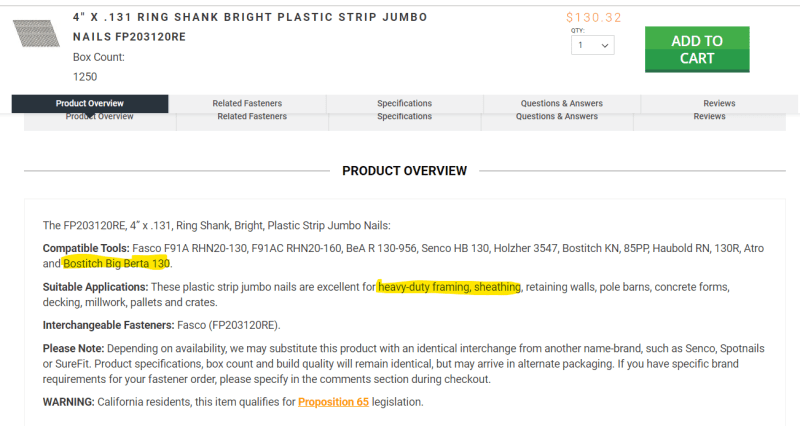

I have a customer wanting to use R12 Zip-R sheathing. (2" foam/1/2" OSB). I hate this crap. Anyhow, the specs require 0.131"Ø nails to penetrate 1 1/2" into the framing. That means they need a 4" long, 10d nail. Does that even exist and for a gun?
That's a good point. If there's a builder involved with the project, ask them if they can get such a nail.
I would be willing to bet that this gets installed with the wrong nails unless there's a lot of oversight. This probably requires a special nail gun, if it even exist.

If the nail gun I need is called Big Berta, I am not sure I want to lug it around all day. Friday Aft chuckle.
I have seen a lot more Zip R since the code update this past yr. Insulation requirements have basically eliminated 2x4s as an option so people are moving to Zip R. I've only seen the R-3 option but looks like they'll be getting Big Berta and oversized nails for this one.
These guys here using a pretty awesome high pressure nail gun, the Max HS130, for the exact situation: Link
A great channel to follow as well, I like to pretend all the framers we work with are this competent - it helps me sleep better at night. I believe that nailer can do up to a 12d common diameter that's 5-1/8" long, so the complaint about not being able to find collated common nails isn't that valid. This high pressure system also means the weight of the nailer is pretty lightweight, though is does require a special compressor.

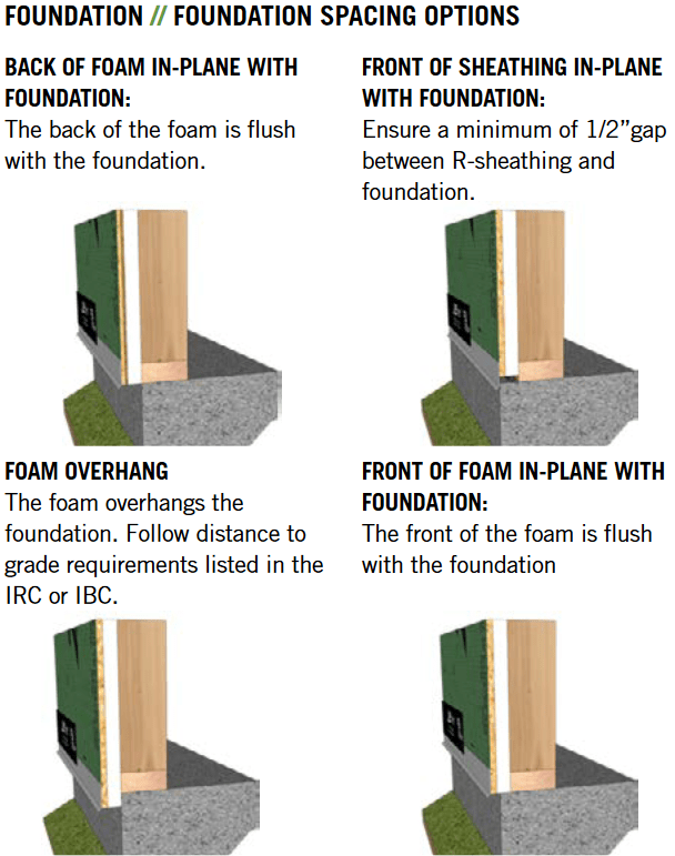

Most houses I work on have the Zip supported on the foundation.
The Huber docs specifically tell you not to put the OSB in contact with stone, masonry, or concrete. So unless you have a flashed ledge above grade for your OSB to sit on, we're back to something having to cantilever OR relying on the foam in shear and/or bearing.
(Sorry...I'm feeling oddly argumentative for a Monday morning...)
It sits on the PT sill plate -which is not even shown in those pics.
