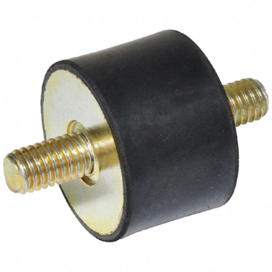

Real isolators are flexible in 3 directions.
Might use studs bonded to each side of a rubber biscuit.
If through bolts are used, there must be no metal-to-metal contact, and tightening the bolts must not overly compress the rubber.

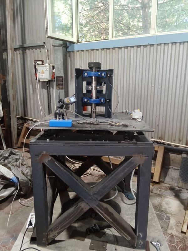

Here is one method -
If a component directly bolted to a rubber pad the upward vertical stiffness is the very high stiffness of the bolt.
The vertical downward stiffness is that of the rubber pad. If the preload of the tightened bolt is sufficient, the there will be no vertical deflection until the applied force exceeds the preload.
The most important thing in the motor balancing process is to avoid a situation where the natural frequency of the system vibrations coincides with the motor rotation frequency. This phenomenon is called resonance, and it can lead to a significant increase in vibration amplitude.
In the context of an impeller motor installation, the use of vibration isolators, preferably spring isolators, is recommended to create conditions where the motor on the springs is slightly rocked. This allows the resonance to be shifted to low frequencies, well below the operating frequencies of the motor.
Here are examples of such stands, there is a video down there with a small engine. But the principle is also suitable for large engines, the principle is the same ..... or here for example :

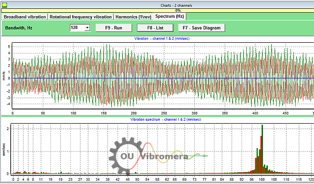

There are two simple experimental ways to determine the resonance.
1. Spin the rotor to the maximum frequency, turn off the rotor rotation and observe the vibration level until the rotor comes to a complete stop. By plotting the vibration you can see a sharp increase in vibration, which will be the frequency of resonance.
This is how it is shown on this image, for example. The resonance is at 700 rpm. You need a sensitive palm and a laser tachometer to determine the resonant frequency :)
2. Shock method. For that you will need any vibration analyzer. Here is an example:
Go to the spectrum graphs .Press the button to start measurements and hit the structure with a heavy mallet or sledgehammer preferably through a wooden spacer.
The analyzer makes a measurement and also displays resonant frequencies on the graph.
This is how it is shown on this image, for example. The resonance is at 100 hertz, which is equal to 6000 revolutions per minute.
