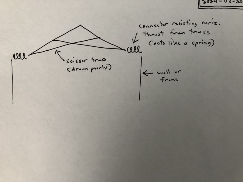

I don't think it's as simple as there being a free 1/8" displacement that you can then use to justify a roller type connection. That displacement of the connector would only occur at the rated load capacity of the connector, and if the wall (portal frame) can't resist that same load, then it would never be realized.
Here's a sketch:
I think if you were to model this accurately, the model would need to account for the stiffnesses of the truss, the connector (like a spring), and the wall (or frame) at each end of the truss.
If the wall was infinitely stiff, then all the horizontal displacement would be in the connectors. If the wall had no stiffness, then the displacement would be only in the wall.
