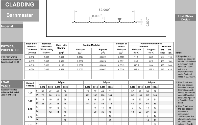

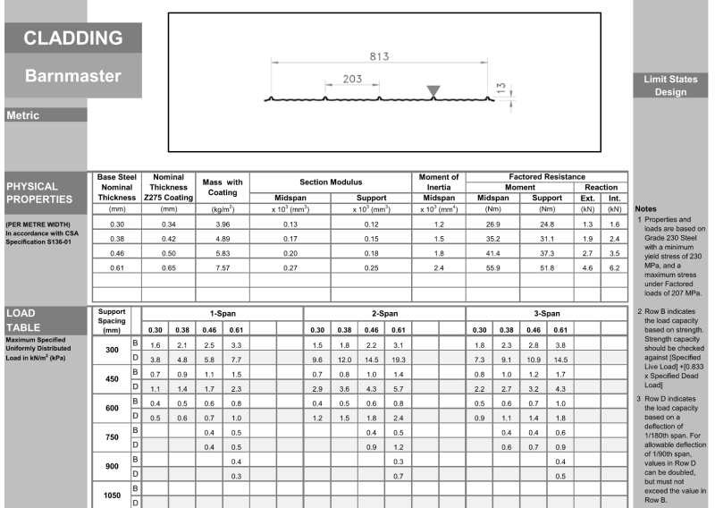

The common cladding thickness in pole buildings we see is shown below.
AISI S310 Can be used to evaluate the in plane shear properties of light gage profiled sheets. Its not an easy road to head down. Ideally the diaphragm strength is controlled by the fastener bearing. There are instability failure modes of the panels that need to be evaluated which can be rather complex. There is a wide variety of light gage panels that are used in roofs, some of them are quite capable diaphragms, others are just to keep the rain out.
