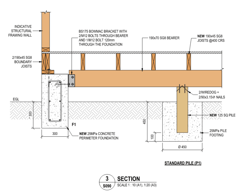

We do a lot of houses that use a ring-and-pile foundation i.e., concrete perimeter and internal timber piles
The perimeter is typically a 300mm wide trench and that has no polythene in it
We increase steel side cover from 50mm to 75mm for pouring against dirt and away we go
Yesterday I was on site and the contractor was insisting that there would be polythene in the trench
I'm 99% sure this was just because I was telling him to cut a bunch of roots back out of the trench and he wanted to be lazy and use polythene to keep them out instead
But I thought I'd go to the crowd and see if there is anything I'm missing
What do you lot do?
Edit: just to be clear, this is NOT for slab foundations. These always have DPM.
This discussion is ONLY for foundations of ring and pile type construction - see example below

@human909, there is a huge difference. DPM is a moisture barrier that prevents damp rising through the slab and into the house
It is absolutely required for slab-on-grade foundations and you'd be non-compliant/creating a health hazard not to use it for slab construction
For subfloor construction it is not strictly required as there is an air gap between the ground and the floor (minimum 450mm to underside of joist in new construction)
Typical practice is to put DPM down under subfloors anyway so that moisture can't even get into the subfloor space
The question specifically relates to perimeter footing trenches though
There is a slim potential structural benefit as we could reduce side covers from 75mm to 50mm if we used it, but this really isn't important as you just design around it
There is a potential structural downside as you create a slip layer between your soil and foundation that will change that interaction (maybe that's a positive though?)
Really though, my question is: is there any benefit from an amenity/health perspective to putting DPM in your perimeter trench

@ Greenalleycat - I would still install DPC around the trench. Similar to why a DPC layer is installed on masonry wall. Without DPC moisture from footing will travel into your bearer up to timber studs. It might not be alot compared to a slab but it may cause moisture issues around the perimeter (i.e. mold, degrading of untreated timber).
EDIT: DPC - is damp proof course. Added youtube video:
All timber has to be separated from concrete with DPC so there will be a malthoid or similar separation under the bottom plate etc
