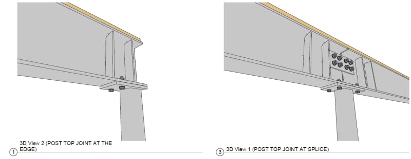

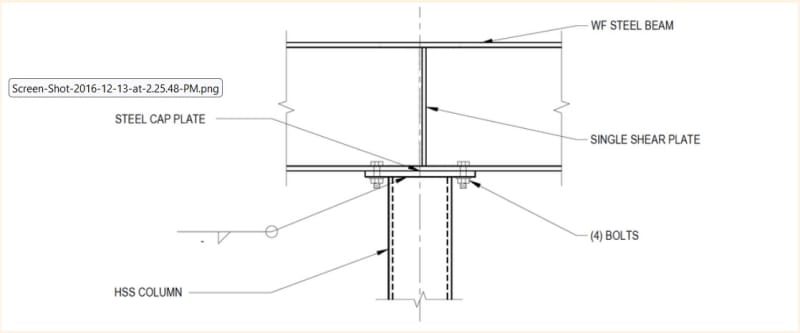

With RTUs the biggest problem is often snow accumulation. This can easily exceed the weight of the RTU. The web stiffener denoted as a single shear plate should be located on each side of the web. It's purpose is not normally for web crippling, but is to maintain the cross section shape in the event of overloading.

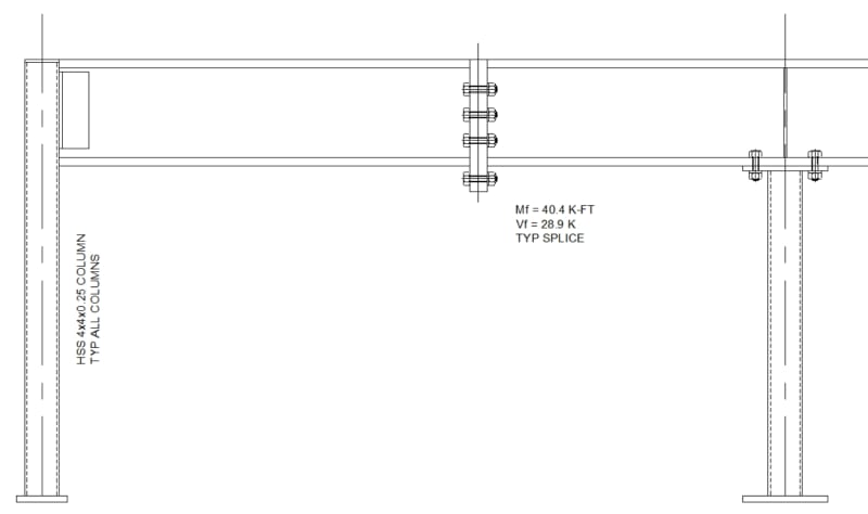

This was a recent project where the EOR had provided the details below. The W beams were W12x35 with simple spans of 20'. My proposed framing using continuity and splices at 3' from c/l of column allowed a W12x30 to be used with the OK of the EOR. My client had already sourced the W12x35. I'm not sure how the web stiffeners on the EORs details worked. New framing worked and is a lot easier.

What the EOR showed, with the stiffeners is probably there to brace the bottom flange and stabilize the column. (See AISC/SSRC Basic Design for Stability, Lecture 4, slide 56).

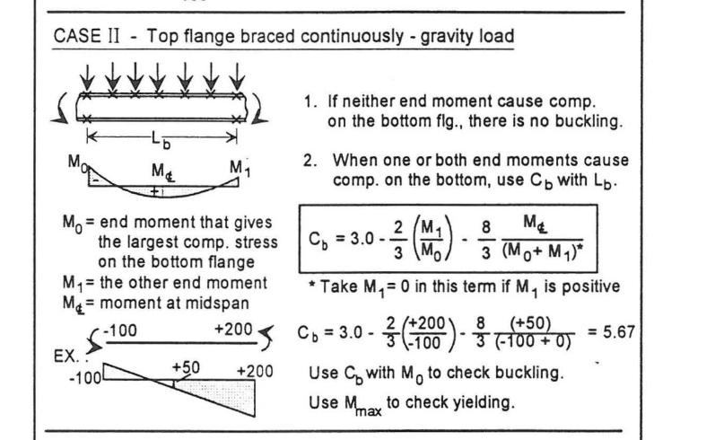

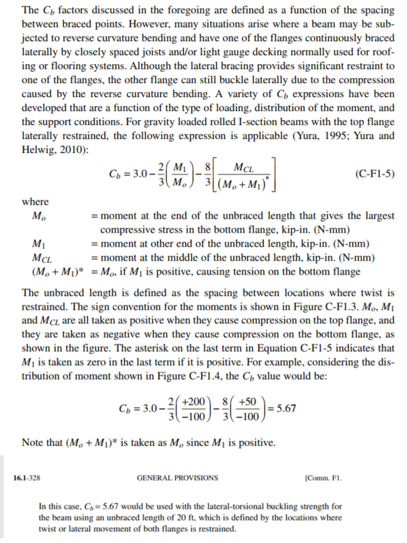

Quick tip: you can use an increased Cb factor (w2 in canada) for this situation (Assuming you have twist prevented at supports and top flange support).
Yura - Bracing for Stability
AISC commentary

Concur... but two 60' W12x35 would normally be more costly than two W12x30, with connections and details being the same.

Beams designed plastically and you need to develop 25% of Mr. The section is Class 1. A W12x26 works, but is not Class 1... else it could be smaller.
