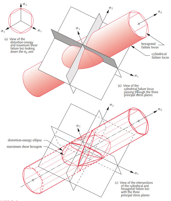

Here's a handy picture:
There is an element of this where it can depend on if you're trying to assess ductile or brittle failure. Or there may be situations where you might not be simply trying to assess failure on a peak point stress basis, you could be interested in the actual element state of stress.
But in general for peak point stress MoS the relative conservatism of the failure envelope can be visualized in the attached picture and some of the others I put in the other threads.

Regarding von Mises vs. Tresca, I think that von Mises is generally preferred theoretically to predict yielding in ductile materials, but in the old days, Tresca was somewhat easier to compute (not as many squares involved), and the difference between the two is not that great when you consider the uncertainties in all the other factors. FYI I have attached a page from a book that shows comparisons of test data to von Mises and Tresca (Plasticity: Theory and Applications, Alexander Mendelson, Macmillan Company, 1968).
 https://files.engineering.com/getfile.aspx?folder=a546c722-36c5-4991-a5e6-8245384b9bcf&file=Tresca_vs_Mises.jpg
