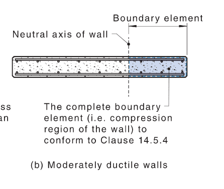

Hi all,
I had a discussion with a colleague about the requirements for boundary elements in limited and moderately ductile shear walls. According to the code, boundary elements are required wherever the peak stress in the wall exceeds 0.15 f'c. The debate revolves around which earthquake load should be used for this check: the elastic load (mu=1, Sp=1) or the design earthquake load (mu=2; mu=3 and Sp=0.77; Sp=0.67). The code states, "The stress referred to in Item (b) shall be calculated using the design action effects for the strength limit state, a linear-elastic strength model, and the gross cross-section properties of the wall." This seems to imply that the reduced forces should be used, not the elastic forces, which has always been my understanding.
My colleague noted a potential issue: if a limited ductile wall requires boundary elements because the stress exceeds 0.15 f'c, the structure could be reclassified as a moderately ductile wall system. This reclassification would significantly reduce the earthquake design actions, potentially bringing the stress below 0.15 f'c, and thus not requiring boundary elements. This creates a paradox where a shear wall with higher assumed ductility would require fewer boundary elements than one with lower assumed ductility, which doesn't seem logical.
This raises the question of whether we should assess this stress based on the fully elastic response (mu=1, Sp=1), similar to the process when checking if any portion of the wall experiences tension (which requires designing the wall as a column). The problem is that the code specifically advises against this!
Another point to consider, which could help resolve the above paradox, is the interpretation of clause 14.7.1 (b), which states, "Moderately ductile structural walls shall conform with Clauses 14.6 except [...] in Clause 14.6.2 all vertical reinforcement in boundary elements shall be restrained in accordance with Clause 14.5.4 irrespective of the calculated compressive stress." This could be interpreted so that boundary elements need to be detailed at all levels, at all wall ends, corners, and intersections, even where compression forces are minimal.
I've always interpreted this clause to mean that, for moderately ductile walls, detailing according to 14.5.4 applies without distinguishing between 0.2 f'c and 0.15 f'c, but the boundary element zone would still be designed only as the zone where stress exceeds 0.15 f'c. However, this discussion has left me uncertain, and I wonder if the clause implies that boundary elements are required everywhere, even for stresses below 0.15 f'c. If so, what should be the length of the boundary element if no stress check is required? Should it be the greater of 0.15 Lw and 1.5 bw, as per the critical tension zone for minimum longitudinal reinforcement? The code and commentary don't seem to specify this at any point.
I'd appreciate your views on this and how you interpret these clauses in the code.

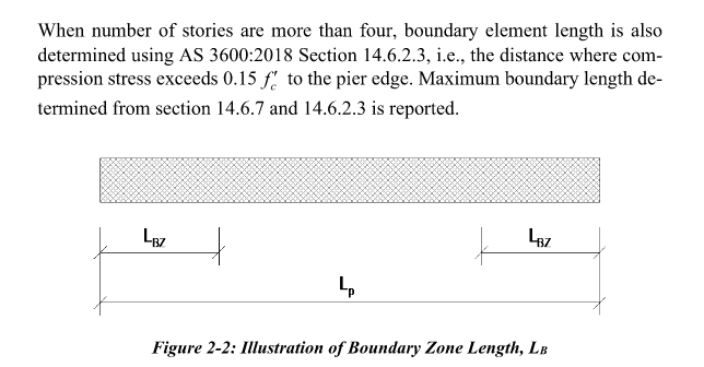

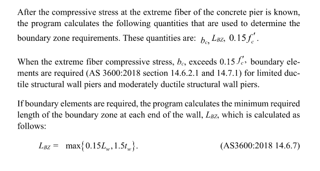

P.S. I was also reading the Shear wall design manual in CSi ETABS, and their interpretaion is similar to my original interpretation, which I'm not too sure about anymore:
- use design reduced loads
- boundary element required when stress exceeds 0.15 f'c
- detail to 14.5.4 within the boundary element irrespective of the stress
in addition, CSI calculates the boundary length as 0.15 Lw or 1.5 bw (which is not stated in the code)

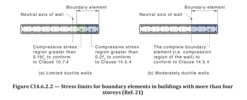

I somewhat agree, however I feel like if that was the case they would have clearly specified this, as they do for example in clause 11.2.1 (see below - but there are other clauses with similar wording)
The fact that the code specifically refers to "design action effects for the strength limit state" without specifying further, and that commentary also doesnt mention anything on this regard makes me think the intent is to actually use reduced loads.
On second read I don't think you could ever end up with less boundary elements moving to moderately ductile. The commentary explicitly states/shows that the entire compressive zone of a wall will be a boundary element detailed to 14.5.4 irrespective of the stress
My intuition/understanding of ductility still tells me that we should be confining the end of the wall to ensure hinge formation, i.e. it should be targeting the stresses prior to the hinge forming to make sure that actually happens. I'm not sure how the logic applies to compressive stresses given I'm usually more acquainted with the focus on shear overstrength, but I'm assuming it's a similar deal where there's a need to guarantee no failure

Yeah, actually, I saw that the other day after posting this. I had seen it before but never realized the second part of the figure was showing the boundary element starting at the neutral axis.
I've found the paper referenced in the commentary. It can be accessed here: and it shows this:

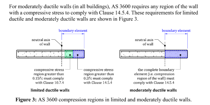

Honestly, it makes little sense to me. First, the code doesn't really say that. Second, this would mean MDW would require boundary elements everywhere, from base to roof, on any lateral resisting wall/core, as there is always a seismic case where the full wall is in compression since earthquakes are fully reversible and can act in any direction. Even the gravity case alone (G+0.3Q with no earthquake) will put the full wall in compression. If the intention of the committee was really to have boundary elements everywhere, they surely would have said so explicitly and not in this ultra-confusing way. Currently, as far as I know, no code requires confined boundary elements for the full extent of lateral resisting walls regardless of the stress and/or strain. In my opinion it's just very conservative, expensive, and unnecessary.
I also found another paper (funnily enough, presented at the same conference as the paper above) that discusses these stress limits, showing how they are inconsistent and overly conservative for any assumed ductility level. Coincidentally, in the paper, they interpret the clauses the same way I do (0.15f'c defines the boundary elements for both LDW and MDW, second page), and they also point out the paradox where we could end up with fewer boundary elements with MDW than with LDW (page 11). The paper can be found here:

I wasn't implying we shoudl apply ductility detail to gravity cases, I was saying that if we need to apply 14.5.4 wherever we have compression stress, then it goes everyhwere because there will be always a seismic case where we have compression stress at any point of the wall, and in fact the smaller the seismic load is, the more will be the portion of wall in compression (neutral axis outside of the wall section), to the extreme that if the seismic load is zero , the the whole wall is in compression and therefore we need 14.5.4 everywhere
On your second point, if we take the image from the commentary, in an isolated shear wall we need to consider as bondary element the whole zone past the neutral axis, which means the whole wall for the reason I explained above.

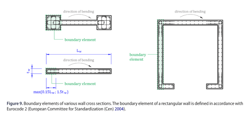

For a core this is not clear, does a corner constitute a discontiuity? I have seen some interpretations like the one below (form the paper RC walls in Australia: seismic design and detailing to AS 1170.4 and AS 3600 by Menegon Wilson Lam and McBean) where in a core the whole side of the wall is considered as boundary element (and I believe they are considering the wrong side becasue the moment direction indicates that the green zone is in tension, not compression). The funny thing is they mention the Eurocode in the caption, however EC8 (not 2, which has no BE definiotns) has a definition of boundary element opposite to this one, where they basically say a return wall in NOT a boundary element (second screenshot).
Once again, lack of transparency on the code leads to confusion of engineers, and even reasearch papers seem generally pretty confused. To be honest I wonder why in Australia we don't we just adopt Eurcodes or ACI, at least for seasimic design, and quit trying to make our own code and make a mess of it.
That Figure 9 you show above is replicated in AS3600 as Figure 14.6.7.
In AS3600 the shaded areas are not defined as boundary elements but rather as critical tension reinforcement zones.
It seems there is confusion in terminology between the Menegon et al paper and AS3600.
Yes I am aware that those figures have been used in the AS3600 for the critical tension zones.

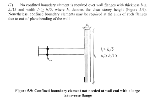

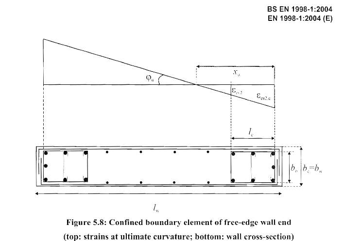

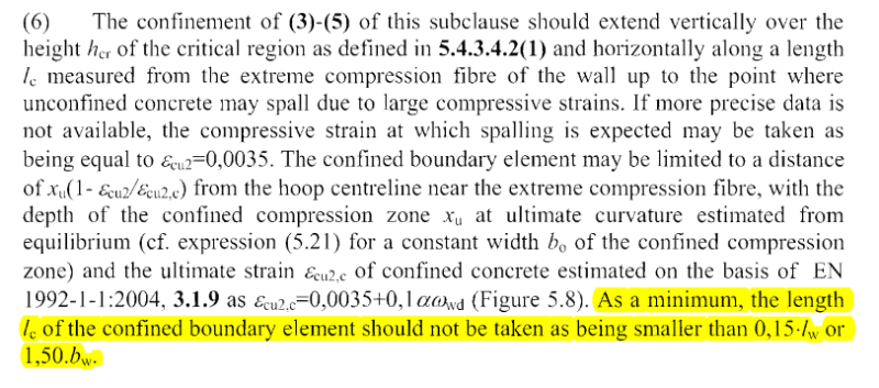

The 0.15Lw;1.5bw length deifnition for the boundary element though does come from the EC8 definition of boundary element - so it seems like there is of mix up of definitions by the committee and/or Menegon et al. i.e. one definition from EC8, another definition opposite to EC8 (refer previous post), paper defines all these as boundary elements, referencing to EC2 (!) and the code takes the same figures and use them for yet another deifinition (albeit somewhat related I guess) i.e. the critical tension zone. What a mess!

Also, figure C14.6.2.2 shows a wall with a neutral axis not in the middle, but closer to the wall end, somewhat indicating that the wall section assumed in not the uncracked one.

I believe the Figure out of the commentary contradicts what is stated in in 14.7.1(b).
Yeah, exactly.
Also, looking at other codes (EC, NZS) the neutral axis depth considered when determining the boundary element region is generally calculated at ultimate limit state, never for the "uncracked" gross section.
