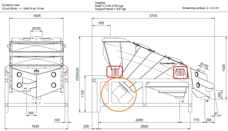

So I'm designing a factory that has a vibrating equipment on one floor. The load is given like this:
Do you have any thoughts what that "6 pol" might mean?

I tried to enlarge the image a bit to make your queried text slightly more readable.[ ] It didn't help very much, but got me wondering whether what you read as "pol[ ]50Hz" might be "p[ ]at[ ]50Hz".[ ] But then that would merely move the problem along to what the "p" is.
Engineering mathematician / analyst.[ ] See my profile for more details.
I would guess it means a 6 pole 50 Hz motor on the machine. Then there is a load cycling at 16 Hz. What is the machine?
It's some sort of a grain grinding mill I think.
I agree that it probably is a 6 pole 50 Hz motor. The load is +/- 2445 N at 16 Hz, but what is the direction of the load. For a rotation machine I would assume a rotation load but here it might be vertical +/-. And how does it vary in time, sinus-function at 16 Hz or something else?
That looks like a layout drawing or something. You should ask for the vendor drawing, it should usually be clearer.

I'd guess with a 90% certainty that it is a vibrating sieve for sorting out suitable sized output from unsuitable sized output. The loads size, the loads frequency and the floor penetrations are very good clues. The fact that it is a grain mill is a big give away. (The hexagonal columns of bulk storage bins on the top of the drawing are also a good give away.)
I've dealt extensively with these machines and the problems their vibrations cause. I've seen them vibrate entire building and their foundations. With vibrations being observable over 50m away through the earth.

OP here. Received a little more info on the machine. The "6 pol 50 Hz" does indeed mean that it is a motor with 6 poles operating at 50 Hz as many of you thought as well. It is a screening machine/sieve for separating grain, I think. It has four supports with some dampers as well (in red on the drawing). But other than that the supplier could not answer what the function for the dynamic load might be or what would be the allowable deflections for the support structure.
This is a schematic for the machine:
One more thing - the supplier wants the openings between the steel beams cast in concrete under this thing, something like this is done in other factories - there is a 200 mm concrete slab between the I-beams:
I did run a time history analysis in Robot Structural Analysis for the beams that support the thing - but I really don't know how to adequately take into account the concrete between the beams so I just added it as mass to the beams and then ran the calculation - even though the concrete in reality probably adds quite a bit to the stiffness of the beams. The natural frequency of the system modelled this way is around 8 Hz. I then ran the analysis with the given dynamic load at the given frequency with the load pulsing to a sine function. The maximum displacement of the beams under this dynamic load is 0,4 mm according to the analysis. But this is achieved with some quite mean beams - IPE400 sections while the span is only about 5 m :)
