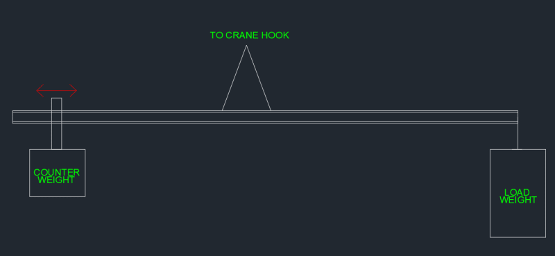

Does anyone have any good reference material for design of a cantilever lifting system used by a crane? Wanting to start digging into this for our company. Eventually would want to add some ease-of-use features for in field adjustment, but I'm just curious about more basics of it right now
A coil hook comes to mind. Please put up a sketch of what you want to do.
Something like the attached. Basically a heavy I-beam structure with counter weight on one end and the suspended load on the other end. Ultimately the goal would be to be able to live adjust the location of the counter weight for quicker multi lift scenarios. But this is the general idea
It looks very difficult to unload the counterbalanced load weight without setting the counterweight on a surface. How big of loads are you referring to? How much cantilever?
I cannot recall ever seeing such a device. Tower cranes operate a bit like this but require a very skilled operator to handle the changing forces to keep the beam balanced. This looks like a great way to do a lot of damage.
you're lifting double the weight?
Can't see any upside to this at the moment
This is actually a very common piece of equipment in our industry. It allows users to reach up under structures with roof height restrictions to still perform the lift to extract the load.
Got any pictures or links?
That's not a cantilever though. It's a balanced beam.
Cantilever implies a moment at the end of the Cantilever. Your sketch only has bending.
Who makes the devices that are common in your industry?
Take note of the typically wide spread of the lifting cable attachments to the beam, particularly that one line goes to the counterweight, much different than the sketch.
Examine existing devices for how they function and find a qualified Structural PE to do the calculations.

I'm wondering 🤔 if an alternative is to locate the counterweight on the floor and run a winch to the end of the beam using the level of the beam as a control input???
So long as the winch is faster than the crane speed it would save all this counterweight movement.
But yes there seems to be plenty of competition for a relatively small market? Unless you know better??
What are you trying to do? Beat that Barnhart company's offerings? Good luck.
