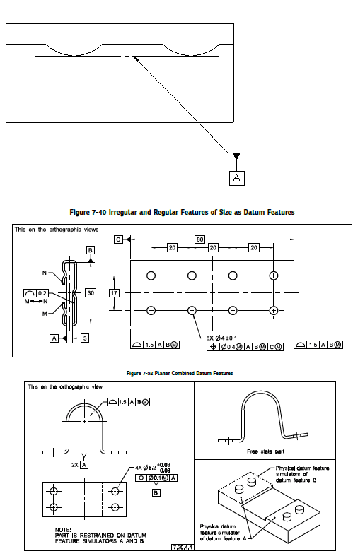

I have a part with two partial cylindrical surfaces and I want to make a datum that is the plane tangent to the two surfaces, as the mating part has a flat surface that is seated up against them.
Part is similar to this example I mocked up:
And I want the datum to be tangent to both surfaces, like so:
Can I just sketch a line between them on a top-down view like in the above picture, and attach a datum to that?
Use two datum target lines, indicating each at the tangent of each arc. Then, target A1 and A2 will be understood as the plane that you are asking about.
If you're not familiar with datum targets, I can post a picture from the ASME standard.
Graphically, Y14.5-2018 accepts a line/circle at the peaks of features for indicting a datum feature.
Examples:
Figure 7-40 Irregular and Regular Features of Size as Datum Features
Figure 7-42 Possible Datum Feature and True Geometric Counterparts From Three Pins Used as an Irregular Feature of
Size
The datum plane is intended to be tangent to the curved surfaces at two line elements (well, nominally) at the peaks. This means only those local elements will be used to establish the datum and not whole surfaces. The standardized way to communicate this is to use datum targets - specifically in this case, datum target lines.
Then, I agree with Garland. And, I would additionally suggest drawing a phantom line between the two datum targets lines (which would be shown as cross-type points on the true view) to clarify that the targets are formed by a single planar datum feature simulator tangent to the two curved surfaces.
The standardized way is shown in the standard in the figures I noted.
Datum target lines will have a definite location. The tangents will not, but the tangents will represent the action of the mating part which the target lines will not.

Do you know how to create this phantom line shown in Figure 7-52 (see attached)? I use Solidworks 2023, and I don't see a function or a command to create the line. I ask this because this is supposed to have gaps between the features and ends of the line. Do you just draw the line tangent to the features with whatever length you need?
Best regards,
Alex
 https://files.engineering.com/getfile.aspx?folder=63f297c2-5836-4a49-aefe-1659c80323ae&file=Figure_7-52.PNG
Yes, you are correct. It is a thin solid line, similar to extension lines in dimensions. Now, do I have to control the gaps manually?
Please take a look at Figure 7-42 attached. How do I add these 3 arcs?
Best regards,
Alex
I use to add drafting aids as model curves and put them on a layer "DRAFTING_AIDS" so they could be hidden on the part/assemblies and shown in the drawing. Just create them the same as any other curve. That way they are tied directly to the model and cannot be left behind if the views move.
Since the datum in Figure 7-42 is a surface I would likely create a surface in the model in order to attach the datum feature symbol. I had no need to use it, so I am not sure it would be a DRAFTING_AID, but the visibility needs to be managed separately from the curve.

Alex,
In 7-52 it is an extension line from the planar feature(s), as Garland noted. When you place the datum feature symbol on one of the lines representing the surfaces and move it away until it is offset, the extension line will appear (unfortunately without a gap in most CAD software). Then some software will allow you to prolong that extension line manually (and you would until it reaches the other feature).
For Figure 7-42 you would probably need to draw a circle as a construction geometry (or three concentric and "co-radial" arcs if you insist on the gaps and not too pressed for time) or use the method 3DDave proposes.
