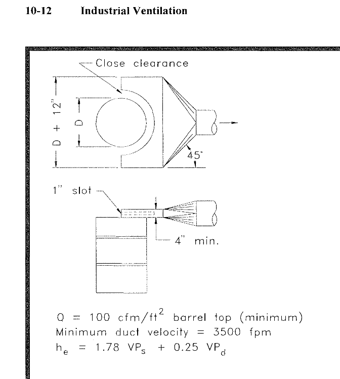

Hello,
I am working on designing a ventilation system for a 55-gallon drum. The goal is to remove as much contaminated airborne material from this drum as possible. My question is how to determine the point of diminishing returns on the throat opening to the vent device. I currently opened it from 1.25" opening to a 3.75" opening figuring I'd sacrifice some air velocity for more surface area. I don't have fluid flow software to model this so anyone with practical knowledge would be greatly appreciated. The air scrubber provides up to 750CFM.
Does anyone have any input/experience with this?
Thanks,
~Anthony

The drum contains highly radioactive material, beyond that I can't share. Workers are in their own breathing apparatus while working around the drums as an intake of this material could be detrimental to their health.
The operators are reaching into the Drum, so I need to keep it as open as possible so they can work unobstructed. They are OK with the design I have thus far, utilizing this hood design tangent to the drum.
My worry is if I close the opening too much, increasing the velocity, there may be material that won't be received by the hood due to minimal opening of the hood. Or will opposite happen, will the increased velocity flowing into the hood actually pull more from the drum?

Is it possible for you to make that sucking frame with a full circle shape? even with one or 1 1/2" height? if you suck the air from all the sides of the drum it will work. In this case the only risky part will be the center of the drum which is solvable.
Very little information here. Are you loading or unloading the drum. I've seen this design used. It is about the cheapest option possible but works better than nothing. Air being drawn from behind the operator will form eddies that blow dust into his face, but the respirator takes care of that.

I attached an image from the ACGIH Industrial ventilation manual.
Variables:
Q = flowrate CFM
h_e = overall hood entry loss
VP_s = slot velocity pressure
VP_d = duct velocity pressure
