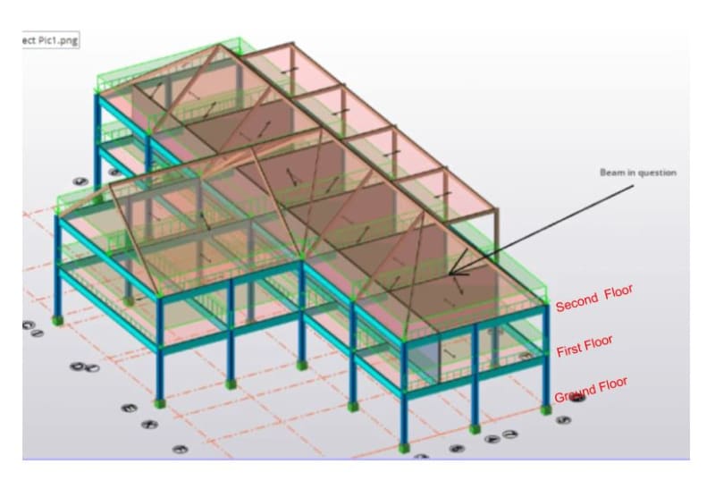

I am currently working on a hypothetical project for the following structure:
Firstly, I am tackling the load distrubtion on beams in kN/m from an applied area load in kN/m^2. I am analysing the load that comes from the floors including the imposed load which is 2.95 kN/m^2. You can see how the load is distrubited in the following figure:
I am confused how the load has been distrubuted to the following beams. The distributed load changes after the intersection of the wall.
To get the UDL I multiply 2.95 kN/m^2 by 5m (the panel widths) which gives 14.75 kN/m. However, this load does not extend across the whole beam. It reduces to 11.8 kN/m.
I guess the wall has something to do with this change in load, but I don't know why. When I look on the plan I feel that the beam should be 14.75 kN/m all the way along the beam; that is the area load should be multiplied by the panel width to get the load in kN/m.
Why is this happening? Thank you in advance and I hope I have explanied myself clearly enough.

Its okay, guys, I just removed the steel beam from the top of the wall and I got a constant load of 14.75 kN/m.
You had a wall and a beam in the same location in your model. The software was applying a portion of the distributed load directly to the wall panel and the remainder to the steel beam which is why when you looked at the beam the load stepped down where the wall co-existed.

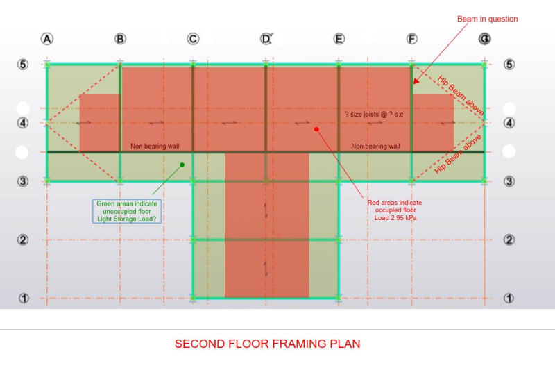

Part of my problem is that you don't label which plan you are showing. The beam in question appears to be on the second level, i.e. the ceiling level. If that is a floor, three edges will not sustain floor load because of roof slope. 2.95 kPa seems high for a ceiling, and if it is a floor load, the loaded area will be reduced because of the reduced headroom due to roof slope.
You need to make a framing plan for first, second and roof levels, with arrows indicating the direction of joist spans and the location of all beams. As it is, there is more than one interpretation for beam loading.
I suggest you drop Grid-lines 6, 7, H, I, L and K for easier understanding (although that is by no means mandatory).
Just a few suggestions. Please do not take offense.
I have made this house to have a loft space; if you see there are dormers at the back; it is the floor load. That is why am using the 2.95 kPa: 1.35*0.5 + 1.5*1.5 = 2.95.

The occupied area is shown in red below. The beam in question carries only partial live load, so it is understandable that the load to the beam in question would vary. But it's not a major difference and for simplicity, you may wish to use the same size beam on Gridlines B to F inclusive. I know I would.
You should label joist sizes, beam sizes and wall designation on plan. If you prefer, you could label walls W-1, W-2 etc. and detail them elsewhere.
Yes, BAretired, for those areas (not in red) I would use the loading for roof space, which on my loading sheet is 1.35*0.25 + 1.5*0.25 = 0.71 kN/m^2. I have learned that its good to group members, so I would use the same beam size for B-F.
