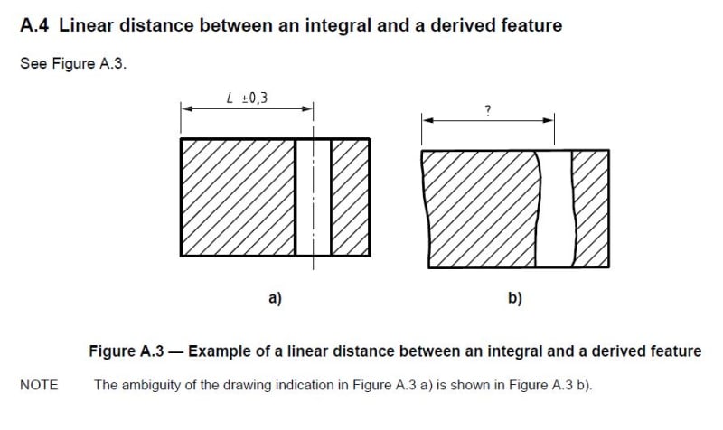

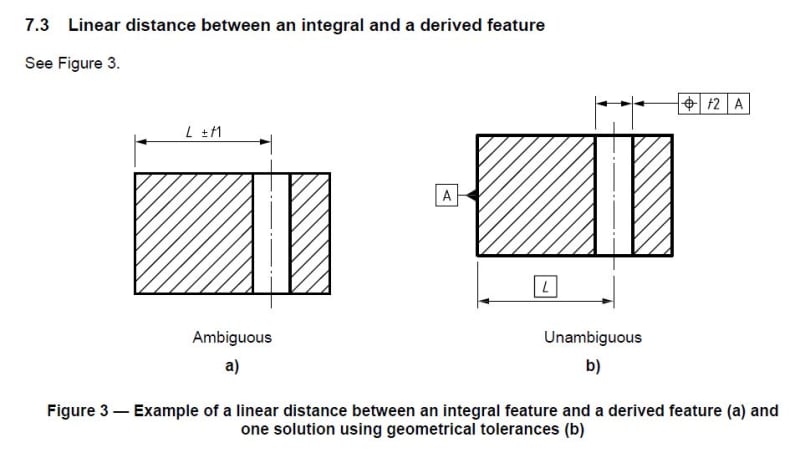

Having said this I am surprised you said the untoleranced 10 dimension is not a standard way of controlling the position of features. Why is that? Can I not use traditional +/- tolerancing to locate datum features? I was doing the same thing to locate A through D using implied symmetry, admittedly I do need to add an explicit symmetry or location tolerance between A,C and B,D somehow as it is important. And I know GD&T replacing all of the +/- location dimensions with GD&T controls would be better, but I didn't realise using +/- dimensions was not allowed!
Sorry I realise I didn't say in my initial post, but this is an ISO drawing not ASME.
Below are two figures taken from ISO 14405-2:2011 (I don't have now access to its latest version from 2018).
When it comes to the use of traditional +/- dimensioning for dimensions other than sizes, ISO does not say it is not allowed, but talks about them in terms of specification ambiguity that increases risk of misunderstanding the definition, hence the design intent. As shown in the second figure, there is an open question on what the +/- dimension really means. Also (this is not shown in the figure), this type of dimensioning generally does not provide clear instructions for the setup of the part for inspection, i.e., order of datums, etc. The approach I always recommend in case of requirements that are deemed non-critical/not important is to use geometric tolerances anyway (to not add to the specification ambiguity), but open up tolerances as much as possible to allow others downstream (manufacturing, inspection) to figure out what sort of trade offs may be acceptable.
Thanks pmarc, that makes sense, I can see how the linear dimension is ambiguous.
