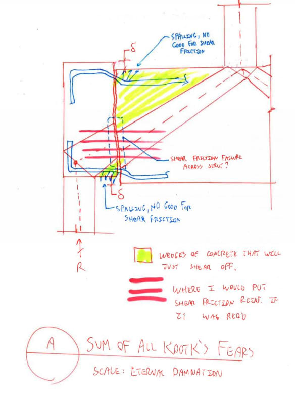

This was a case where an intentional crack was induced, but where a potential crack would likely form anyway due to shrinkage restraint.

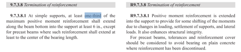

I also provide top bars at the ends of simple supports. This was the way I was taught to detail and to me it's for the convenience of being able to hang the vertical stirrups. I believe there have been discussions here about providing a minimum 1/3 +Moment reinforcing as top bars, but I've searched through ACI 318-19 and cannot find anything on it. Simply, I'm not sure why we are putting top bars other than a) old detailing habits b)place to hang stirrups.
Now correct me if I'm wrong, simply putting the same bottom and top bars really "changes" the intended design of the beam. If you put equivalent bars, say (2)#5's top and bottom, you've really just detailed a beam with fixed ends, and not a simple span?

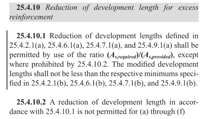

Can we reduce the development length requirement by the amount of excess steel provided?
Good luck navigating this section:
Is basically says, yes you can reduce development length. But for every situation at the end of beam (i.e. non continuous supports) or where a column doesn't allow at least 12" development, you cannot reduced the development length into the column. I take it as, for every location where shear friction is to be developed at the end of a monolithic beam pour, you cannot realistically develop said shear reinforcing unless you have columns that are deep enough. For 90% of typical construction, this is not possible.
I am 95% sure that the shear friction provisions require full development of fy on each side of the section in question. Thus, no reduction in development length allowed.

I understand and I'm not trying to be argumentative (quite the opposite actually, I really appreciate your help) but how do you know when you aren't suppose to rely on it? The way the code is written, it's so vague. They specifically say "existing or potential crack". As far as I'm concerned, you cannot eliminate any potential crack in concrete.
I like when these kind of topics come up because they make you think and challenge assumptions, which is great brain exercise and provides an opportunity to review fundamentals underlying our design practices. I think the code is meant to be vague here, because it's not necessarily mandating that the shear friction model be used. It's saying if you are going to use this method, these are the rules of the road. At least that's my interpretation. It's up to the designer to judge when it's applicable.
Shear friction theory is just that, a theory. It is a set of arbitrary rules loosely derived from testing.
In theory, any arbitrary plane cut through a concrete structure should satisfy a shear friction check. That's not to say we need to check every conceivable location.
Recently I had to do a deep dive into this whole thing, and found that when checking certain interfaces either through monolithic concrete or roughened construction joints, these will occasionally suggest a failure especially across unreinforced or lightly reinforced planes. The more places you start looking for potential failure planes, the more you will find, and I don't believe it is necessarily realistic.

So where do you draw the line? Where do we say a crack might happen here, so we need to satisfy the shear friction theory, and where can we dismiss it?
Typically at transitions from one element to another or at a change in section.
Agree. But the codes say any “potential crack” location, which is pretty much anywhere in a monolithic concrete structure, eg a slab.
Yes, one could interpret that to mean any conceivable plane, but that seems unrealistic.
The “shall apply where appropriate” bit implies using judgment about when and where to apply the method.

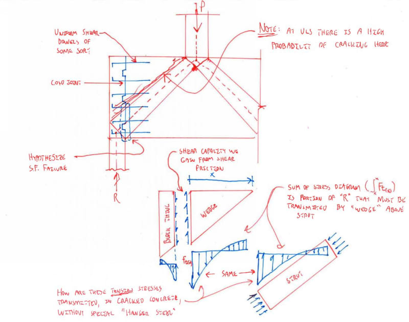

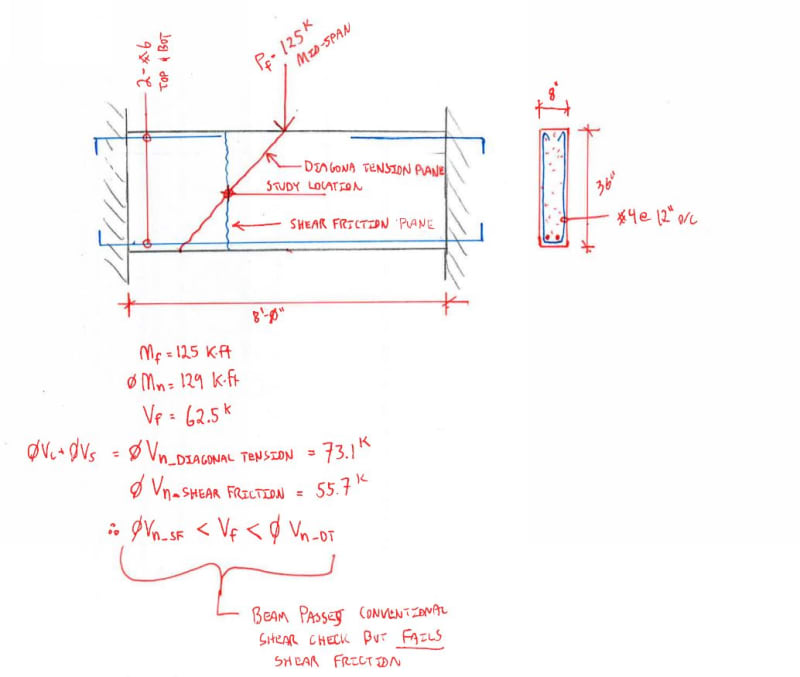

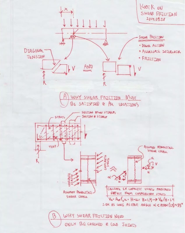

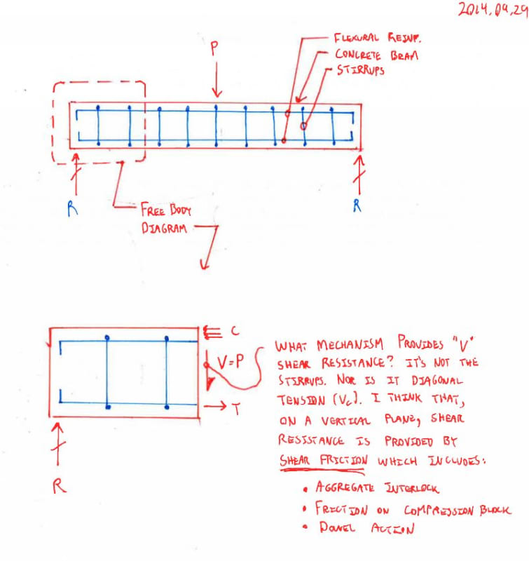

I, and others, did massive amount of work on this back in 2014 that would be worth your time to review: Link
As a teaser, the thread includes the sketches below and some accompanying numerical work.
More from this thread: Link. Seriously, I probably lost two years of my life obsessing over shear friction. Frankly, it's a wonder that I'm still married.
