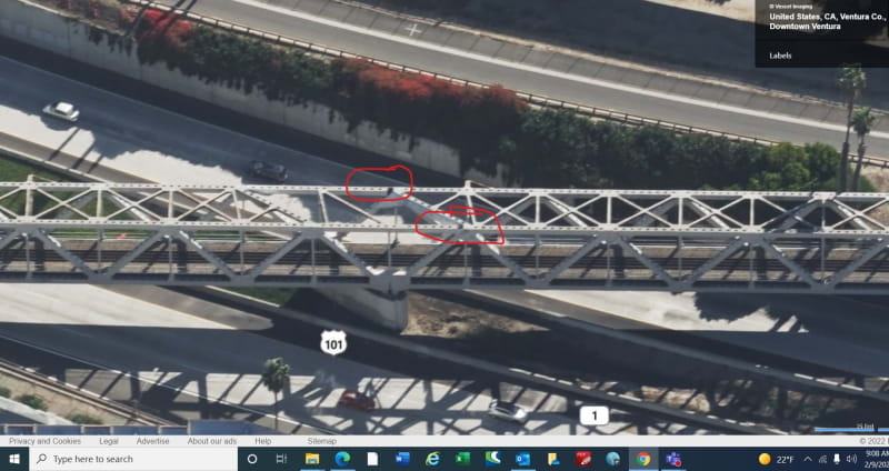

I was looking at the bridge in Bing bird's eye view; the dark area seem to suggest the top chords at one end are only connected to the outside gusset plates. Another observation that hasn't come up: At the pin and the edge of the pin plate there's no sign of paint wear. I discussed this with a colleague, he agrees that we need plans to understand the function of these members. He also believes that the vertical is connected to two gussets at the bottom.
That's a very nice picture. For the area circled by the upper red, you can see the diagonal line of the exposed edge of the end post. And, obviously, the lack of top gussets at either location, unlike the rest of the bridge.
The paint wear point is interesting. If there is no sign of paint wear, I guess that would mean the joint did not move enough to cause it.
Did your colleague see the photo example above that included the red line? I note that only three rivets would make the connection between the vertical and the right-hand gusset. Did he have an opinion of why there were only three on the right while there were 16 making the same type of connection on the left? Surely a curious case of asymmetry.
And I still have a problem with those three either missing the flange on the vertical or being very near the edge of the flange.

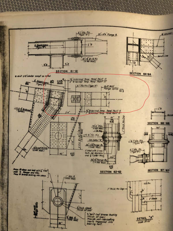

Pins are a typical method of creating dummy members; commonly used on cantilever trusses.
So then would the pins be a loose fit for those dummy members, so that they wouldn't accidentally take a load?

In the detail shown, the pin is in a slotted hole and sits on a bronze angle so that the top chord can expand/contract.
Depending on the contractor's erection method, the dummy member could carry load if the center span is constructed by cantilevering all of the members. Once the closure is made it becomes a dummy. If the contractor elects to raise the suspended portion of the center span into place, then the dummy is always a dummy.
