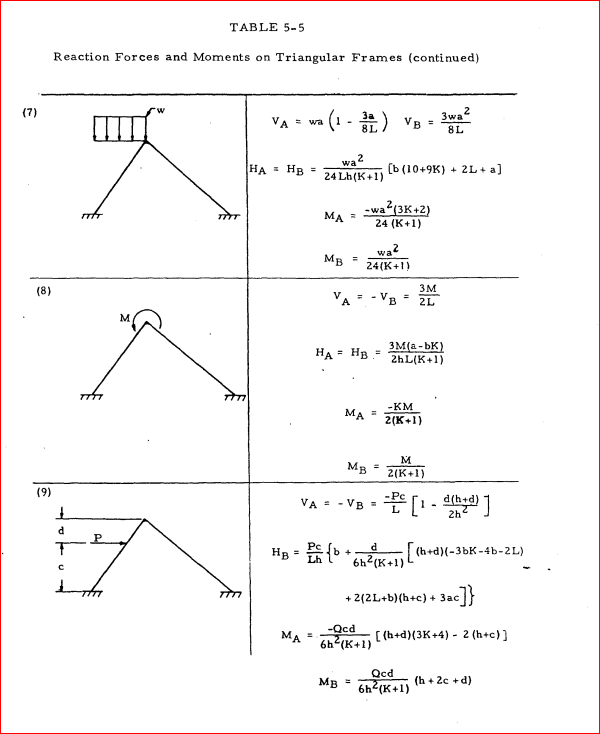

I thought I was close to calculating the reactions in this bracket, when I found the “Air Force Stress Analysis Manual”. Its 579-page PDF file can be easily downloaded for free by searching in internet with those words. The reactions and moments I calculated for a triangular frame (Table 5-5) with all three joints fixed and with an external moment applied (Case 8) satisfied all the Statics summation of forces, but this didn’t happen with an external load (Case 9), so I couldn’t combine those two cases to simulate my bracket, as was my plan. That Case 9 didn’t work even when I tried to solve the exact situation they show, which is that both members are inclined and that the load is applied between supports, not in the overhang as in my situation. So, when I couldn’t even solve the standard problem shown in the diagram of Case 9, plus my failures calculating with Roark and Slope-Deflection, as described earlier, that was when I realized that I need to ask for help. But, of course, these failures could be also because I made a numerical error.

Here are the Air Force images:
BA

Regarding the USAF manual, in my original post I included how to download it, but since you are in the road, here I am attaching the two cases I was planning to combine. But my plan failed because case 8 is not working not even for the configuration they show, without doing any adaptation to make it similar to my bracket (a = 0, and making d = a negative value to locate the force in the overhang), and I think it is because they have a typo with the Q they show in the MA and MB formulas. That Q has to be a force for those formulas to be dimensionally correct, but when I Plugged my "P", the reactions I got don't make the summation of moments equal to zero. I can't imagine what other force can be plugged in those formulas. As I wrote before, they say they copied those formulas from a Handbook by Griffel, but it costs $105 in Amazon.
 https://files.engineering.com/getfile.aspx?folder=310a37e7-e0b3-4b8b-9b03-0be138fd3146&file=AF_Frame_Formulas.png

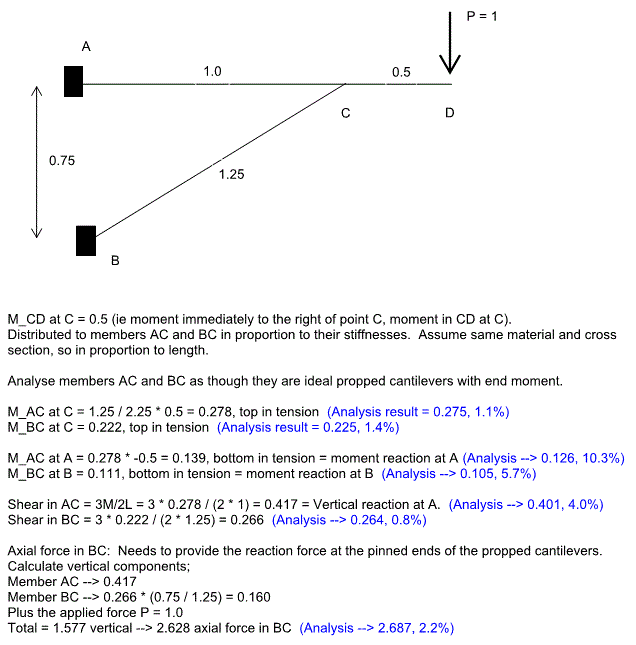

Verifying analysis doesn't necessarily (or often) mean reproducing the exact same answer by hand. If you have FEA results, appeoximate checks that bound the answer (eg the pinned assuption, and a propped cantilever analysis) may even be better. If the check calc is too complex, you run greater risk of an error in the check as well as the FEM analysis.
Here's my suggestion: Use the software and verify by hand with the simplified model treating the connections as pins and the end of the brace to be a hinge. If this gives you a result very close to the software output, then you can just use the hand method in the future. If it gives you results that are kind of close, then you can determine whether they are reasonable (eg the tip deflection is 15% less considering everything fixed than by using the pinned hand method). If either the software results don't make sense (eg there is more tip deflection than the hand method even though it should be stiffer), or they are very far from the hand method (eg the tip deflection is 10 times higher using the hand method), then you can keep investigating.

I saw your pic from the USAF manual. Is it clear that the joint in the triangular frame is fixed, like your sketch ?
I assume the triangular frame is ABC in your sketch, and you're loading it with a force and moment (simulating the load at D).
I think the first question, before analytically considering the structure is to model what the structure really is. Apologies if this has been discussed already. If the joints are welds or multiple fasteners then some fixity is to be expected. If I analyzed the joints as pinned, and a reviewer asked "why not fixed?" I'd say that the fixity moments are small, the simple analysis margins are high, and if he insists we can test the structure (either in situ or on a bench, either the production parts (if the margins are high) or a test piece. But then maybe you don't have the years (decades) of experience that a reviewer can use to appreciate the sense of my opinion. If you are new, then working through a couple of examples will convince you (and you don't need to rely on "some guy on the internet". I would solve with manuals (hand calcs) and FEA. FEA is a very useful tool, and reviewers are always asking "why should I believe your FEA ?" ... it's nice to say that you've hand solved similar structures with similar FEAs and got consistent answers.
Air Force Solution:
Note V & H represent H & V in the OP's model. This was done in a hurry, so should be checked. I couldn't find Q, but it doesn't matter because d=0, so the whole expression is zero.
To find the final answer, use superposition, i.e. add Case 8 and Case 9 together.
BA

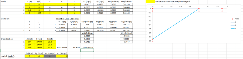

Post some of the calcs you've done so far and we may be able to help steer you in the right direction. Then I'll share a small spreadsheet built from that textbook for your sketch condition.
Steveh49:

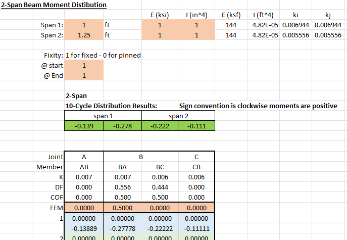

EDIT: I follow what you did now, simple 1 cycle moment distribution simple because both supports are fixed and the members aren't loaded along their length, so 1/2 joint moment carries out to the fixed end. Neglect axial deformation. Split out member AC and BC on their own as fixed-pin beams with moment from the distribution applied to the end. Vertical force to the top of BC = AC right end reaction plus the 1 kip load plus the vertical component of BC right end reaction.
textbook style setup for Steveh49's first steps in getting the moments applied at each end of the members and support moments:

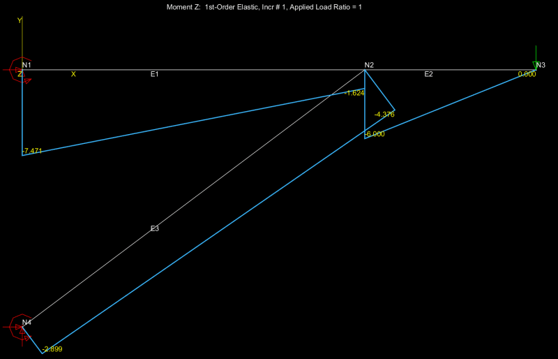

Matrix Analysis Method -- considering first order axial deformation:
Verified by MASTAN2

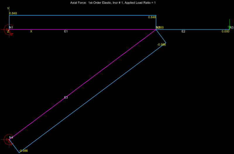

Axial:
Mz:
Vy (local member shear):
Node Reactions:
