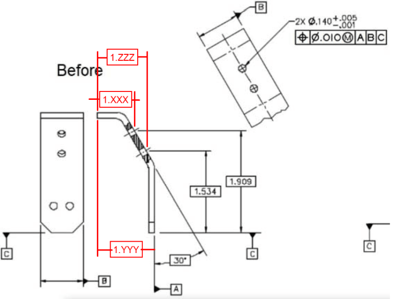

Just to stir the pot a bit: Fig 4-7 -2009 has a 150 basic dimension shown from something that is not a datum feature.
Also 7-55 has a 200 basic dimension to the point where the hole's "true position" (I don't like this term, but I am paraphrasing the book) axis intersects the surrounding face.

Picking up on the points made, how about the attached scheme?
You need to define the basic angular relationship between datum features B and D, or between datum feature B and a hole axis.
Do you have some objection to dimensioning the distance between a hole axis and the intersection of datum features D and B? I realize there are limitless possibilities here, but that option certainly certainly has advantages.
If there is a mating part with a corresponding hole pattern, it could be helpful to make the dimensioning schemes match. Also, it might be a good idea to choose a scheme that doesn't involve non-terminating decimal dimensions which require rounding for display.
Regarding 2018-05-04_111730.jpg posted by SeasonLee:
The problem with the "Before" scheme is that the basic relationship between the hole axes and the datum features is not fully defined. The hole axes are dimensioned based on their intersections with the angled surface, but the basic relationship between that surface and the datum features is not fully defined, so the chain falls apart.
The "After" scheme solves this problem quite thoroughly by eliminating the position tolerance altogether.

The problem with the 'common error' in the example is that as the length of the vertical portion changes the horizontal component of the angled surface changes, so the intersection of the axis with that surface moves horizontally leaving the location of the axes unfixed relative to [A|B|C].
In the 'one correct method' version, the location of the axes is fixed within the [A|B|C] without regard to intermediate geometry.
It seems like a driving principle of true position is that its location is fixed to a DRF.
Evan,
There is all the difference in the world there.
"Before" example controls neither location or orientation of the holes.
So, you need 2 more coordinates to locate the points, 2 to 4 more angles to orient the axes, or make inclined surface datum, specify holes perpendicularity to the inclined surface, all to get to the clumsy, ambiguous equivalent of "After" set-up.
Ambiguous because it is not clear if intersection points are randomly hanging in space or belong to inclined surface. If they belong, then you don't need basic angle, as surface is already drawn thru 2 points, etc., etc.
And you still insist that "before" is actually equivalent or even better?

OK I think I see it now. The Before scheme does not provide enough dimensions to fully define the required geometry, and the After scheme does. With only a Y coordinate for one endpoint of each axis, we don't know where the axes are in the X direction. If we wanted to build a gage to check the position tolerance, we couldn't do it using the dimensions in the Before drawing But we could build a gage using the After drawing. So I agree that from a completeness standpoint, the Before scheme is insufficient and the After scheme is sufficient. Sorry for not seeing that earlier - 3DDave pointed it out as well.
As far as what type of basic dimensions can be used, I would still maintain that the essential thing is that the relationship between the toleranced feature(s) and the datum feature(s) is fully defined. Many different arrangements of basic dimensions could accomplish this. But I would also agree that certain arrangements would be more direct and clear to the typical reader, and other arrangments would be less direct, unclear, and convoluted.
Here is an example. I've added extra dimensions to the Before scheme to make it complete (please forgive the poor drafting technique - I'm not an expert on drawing layout and drafting).
I would say that this dimensioning scheme is adequate, but perhaps somewhat indirect. The dimensions involve the left-hand end surface that is not a considered feature or a datum feature for the position tolerance, and this may be distracting or confusing to many readers. But including dimensions to this surface does not cause any fundamental issues or make the scheme meaningless, because the dimensions are all basic anyway. It doesn't mean that we have to line up on the left-hand end surface on the real part.
For my understanding, the basic dimension on the X-axis is implied zero, so I will think the features already fully defined, its not necessary to add extra dimensions.
I am always learning here, please let me know if I am wrong.
Season
SeasonLee - i think he was just talking about the x and y in the side view that he added the dimensions to, his 1.xxx, 1.yyy, and 1.zzz are all in the x direction he was referring to.
Season Lee,
If the basic dimensions locate the X and Y of the intersections with the nominal 30 degree surface, don't they also set the slope of that same surface in a redundant manner? It would be better to pick some random locations on the axes that are far from the surface to establish their location. If the dimension was to the projected intersection with [A] then only the Y value would be required.
