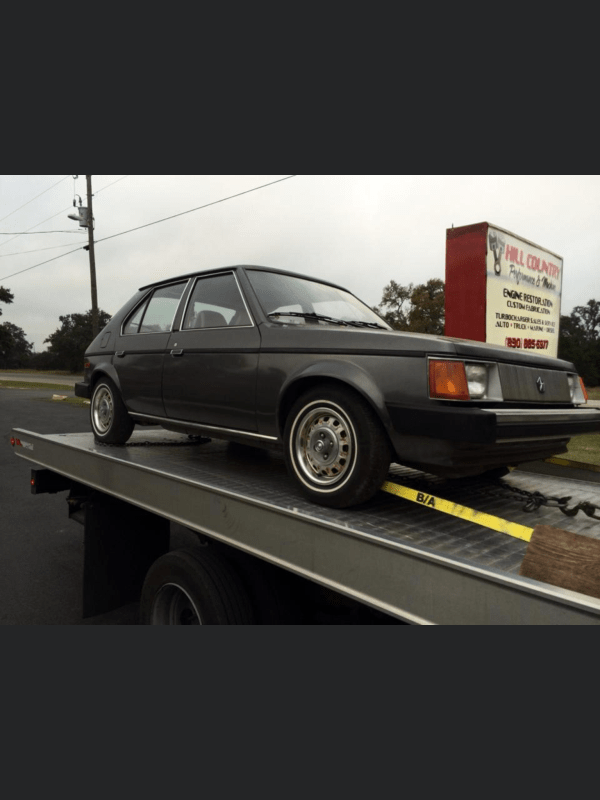

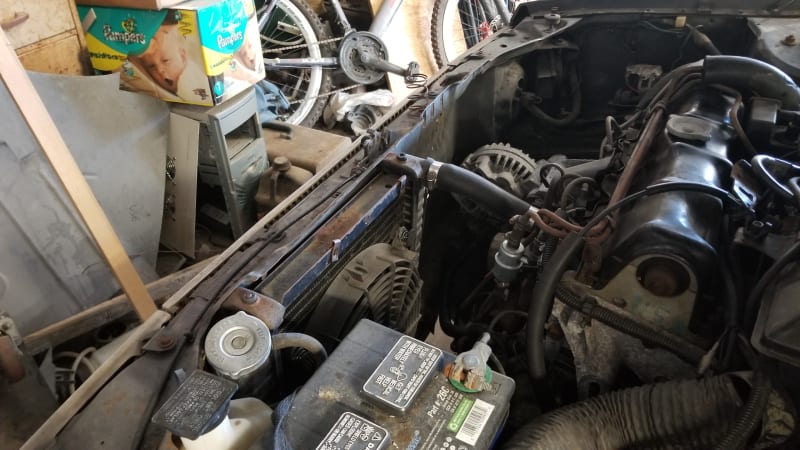

@BigClive: We are duel tracking. We are going to put the original 2.2 back in the 1981 Horizon and run it and modernize the Iron Duke and put it in an S10.

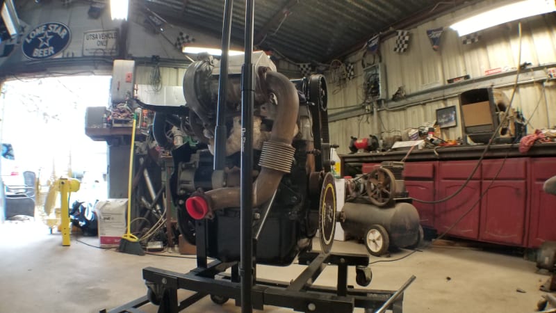

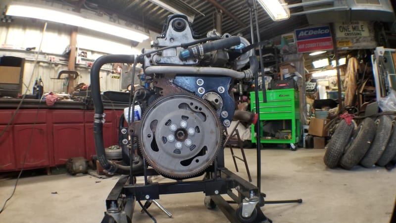

We have five of them. Forensics are being performed on the test engine used for the failed kite version that was being contemplated with Crane. The problem with that one is that it is sort of a frankenstein version. For example the head had plenty of wear and the intakes valves showed the effects of high heat as would be expected, but the cylinders were brand new. The 2.2 that was in his daily driver is intact and has been run on the stand periodically over the years. The Chassis still has the dials as you can see in the picture and the half radiator that many believe to be mythical.

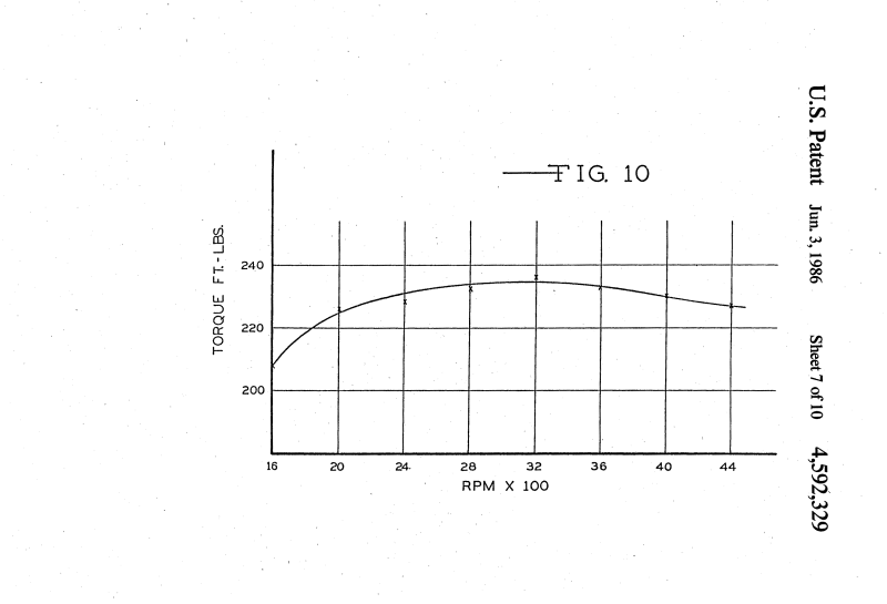

An engine and fuel system embodying the present invention was constructed and installed in a 1980 Buick Skylark. The vehicle weighed 3,005 lbs, two passengers, full fuel accelerated 0-060 M.P.H. in 9.4 seconds. The mechanical parameters for the engine are listed in Table I. A measured torque curve is illustrated in FIG. 10 and indicates a remarkably level torque output, in excess of 225 ft-lbs, for an operating range of 2000-4400 rpm. Those in the art will recognize that the disclosed power output for a three-cylinder engine having a displacement of 125 cubic inches and weighing only 320 lbs. in its operating mode including clutch and bell housing is substantially more than one would expect from an engine this size. Moreover, it was found that the engine was remarkably vibration free and the radiator with which the above identified vehicle was originally equipped was reduced in size and capacity by about 50%.

Horsepower 240 Hp at 4000 RPM (special high performance fuel-test code 20 with 21 pound boost)
Horsepower 190 Hp at 4400 RPM (93 octane unleaded gasoline with 10 pound boost)
Weight 320 lbs.
Fuel economy 48.25 MPG (combined city and highway)
I have to convert those numbers to metric to make sense of them, but having done so ...
The torque curve above coincides with the claim of 190 hp at 4400 rpm, so from that, take the boost pressure to be 10 psi (0.7 bar gauge pressure, 1.7 bar absolute).
The BMEP based upon the claimed torque and RPM is around 19.3 bar.
For a forced-induction engine, at first approximation, divide this BMEP by the ratio of absolute pressure to atmospheric pressure (1.0 bar) to establish an estimate of what the BMEP would be in naturally aspirated form. It's 11.4 bar. This makes an implicit assumption of perfect intercooling.
By purposes of comparison, a run-of-the-mill low performance 2 valve per cylinder production car engine is commonly 11 - 12 bar BMEP, a good production engine 13-ish, and the very best naturally-aspirated 4 stroke spark ignition racing engines that are running on gasoline (no exotic fuel chemistry) - we are talking Formula 1 or NASCAR here - are in the 15 bar range.
So, it's fair to say that whatever cam timing or intake-heating trickery was applied, was probably costing it about 10% - 15% in specific torque. That would coincide with an increase in absolute temperature of 10% - 15%, which is not far off the deficit that one would expect with that boost pressure by not using an intercooler.
