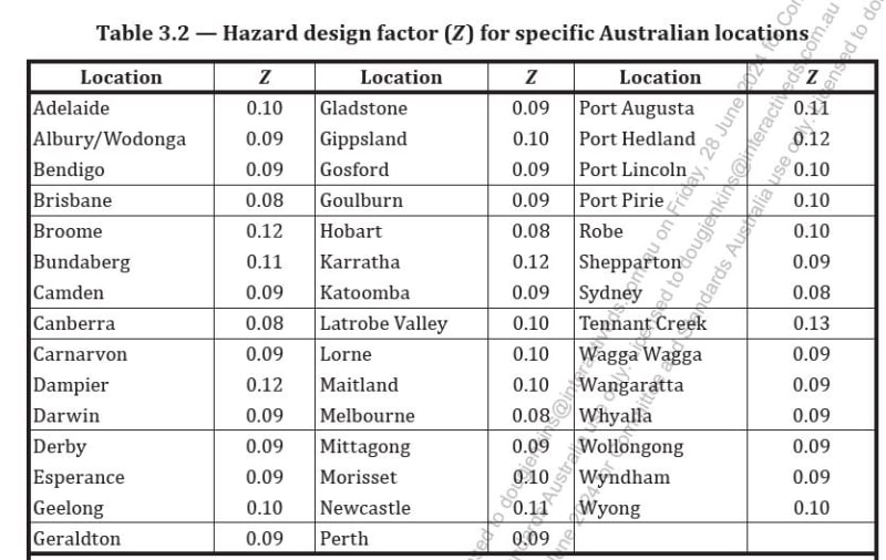

Confusion among designers because the code writers are bad writers. Syd Melb Bne shouldve always been in the table. That's half the population. And map numbers should be between lines and not on lines if IDS and commentary are right. But the commentary is unofficial and out of date now.
You mean this table?

Yeah the table they fixed after the insane decision to delete half the population and cause confusion.
All commentaries are unofficial because not BCA referenced but this one isn't even standards Australia. Judges aren't engineers and would probably be confused too if something ended up in court.
I think the map is quite clear and the table makes it even more clear. There is no interpolation. All zones within a contour boundary have the Z value shown on the boundary, unless they are included in an inner contour with a higher Z value. That's it. Adding the 0.08 point simply says, this zone is 0.08 until you find a boundary with 0.09.
I find many other parts of this and other codes a lot more confusing to be honest
The only quite confusing thing I find is that, jusdjing from the map, Perth looks in the 0.08 zone, however the table says it's 0.09 and I see how this particular case could actually cause a general misinterpretation of the map. Not sure if there are other similar instances.
Perhaps Perth has been assigned 0.09 because part of the region would be across the 0.09 boundary? I do hate how this map has been drawn however, they're not really contours and are more similar to the borders of regions (think 1170.2 zones)

There are other examples where the location falls outside a certain contour on the map but is overridden by a value in the table. E.g., Wangaratta is 0.09 in the table but is clearly outside the 0.09 contour. I suspect back in the past, these were intended to be true contour maps, and at some stage the decision was made to simplify it all by avoiding having to interpolate between contours (hence why we now select the lower contour). Just a guess, there might be another reason.
There are some other quirks in the maps that don't make sense. E.g., Wagga Wagga is drawn on the north side of the Murrumbidgee River, even though it is actually on the south side. Swan Hill should appear almost directly on the NSW-VIC border but there is a fair distance on the map. All this tells me it is not intended to be km accurate.
I'd suggest that the contour maps are what they are. Use the table where you can, otherwise go off what everyone's done on previous Projects.

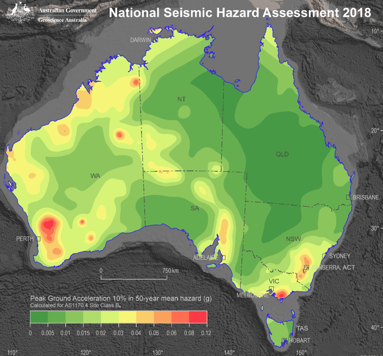

I got this as a third-party certification review query on this a few years back and it led me to Geosciences Australia's "The 2018 National Seismic Hazard Assessment for Australia", website - and document attached.
The most dramatic bit is Section 3.1. "The average percentage difference between NSHA18 seismic hazard values and the hazard factors for localities listed in T3.2 of AS1170.4 2007 is approximately 72% (reduction of the calculated hazard factors from the factors quoted in AS1170.4!).
Essentially through increased ability of Geosciences Australia calculation power / methods over the years (computer advancements etc) the hazard values (calculated ones)are much much lower than the hazard factors (quoted in AS1170.4 for us to design to - note the difference in the definitions, they mention in the assessment report that this is intentional).
For example; AS1170.4 hazard factor for Melbourne is 0.08, whereas the corresponding NSHA18 calculated value is 0.031..

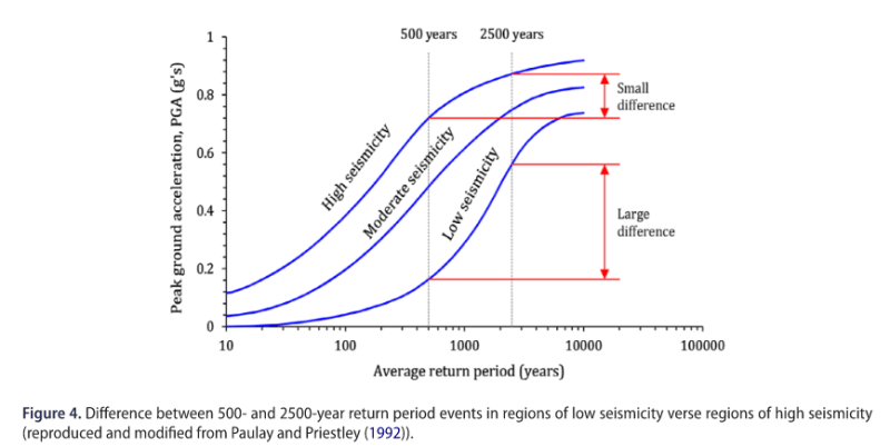

My understanding is that the logic of using such high Z values compared to the actual, newly calculated values, is the dramatic increase in acceleration on 2500y return period earthquake typical of low seismicity zones, so if we designed at 500y for the real Z value, that one time in history where a 2500y earthquake hits, it would obliterate every structure ever designed, hence the decision of keeping the old, conservative Z values.
This is a presentation which addresses this
Ref:
This is a graph that shows visually what I said above
To sum up, when we design for 500y earthquake, in reality in most cases we are not designing for 500y return period, but for a much longer one

I don't think that's correct. That's a 10% probability in 50 years, which is actually a 475y return period.
500y return period will be roughly 1.05 times that, so 0.033
See below the 2018 map

Only three years ago Melbourne felt a 'decently' sized tremor. The epicentre at Mansfield 130km away has PEAK GROUND ACCELATION of 0.20g, so almost 7 times the figure above if you didn't notice the decimal shift. We had an after shock just 2 days ago.
That's quite concerning actually, it goes to show how these assessments can be relied upon only to a certain extent, especially because of the limited historical data we have for Australia, and I'm glad the approach is somewhat conservative in keeping the old Z values for design.
