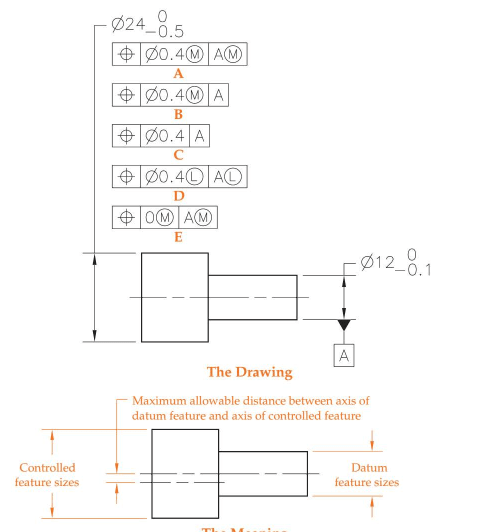

Hi
can any one help on this attached axis to axis shift calculations ?
i am aware virtual condition and resultant conditions but i had confusion on applying datum shift add or subtract ?
long back i worked on stack up method now after a gap i had confused,
please let me your ease way of calculations like any other method apart from stack up.
 https://files.engineering.com/getfile.aspx?folder=cf6a670f-1f11-4730-a71c-d5d543f0d5a0&file=calc.PNG
Gopinath K,
You should take a look at figs. 5-48 through 5-50 in ASME Y14.5M-1994. They should easily let you figure out the correct answers for cases A, B, C and E.
Case D is a bit different. There is the same amount of bonus tolerance as in cases A and B, but for the datum shift calculation you should keep in mind that the LMB size of datum feature A is 11.8, not 11.9 as it would seem at first glance.

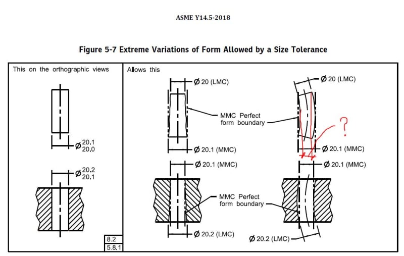

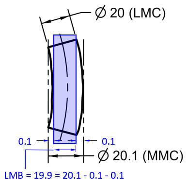

Take Fig. 5-7 as an example, may I consider LMB as shown below, since the form variation 0.1 will happened on both sides.
Edit: LMB could not be a correct term, its not a datum feature here.
Please correct me if I am wrong on this concept.

For case D, LMB is a right term for sure. What I said LMB could not ne a correct term means the Figure 5-7 you posted.
Thanks to the Figure 5-7, it gives me a hint to think about LMB size.

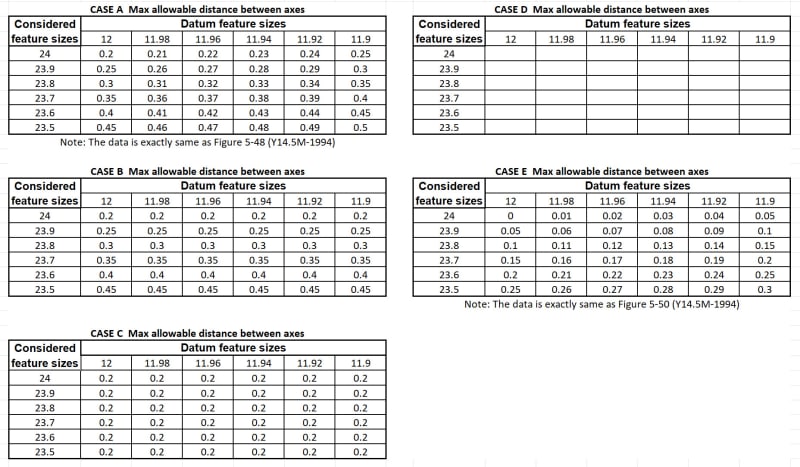

Here is the summaries of the max allowable distance between axes for all cases, as pmarc mentioned Case D is a bit different, and its really a bit difficult fo me to calculate the max allowable distance between axes, hope you guys will help me to fill it up, attached is an Excel file, it will be easy to edit. Thanks for your assists.

By supplying these results rather than showing the subject at hand - the geometric relationship - the topic is completely obscured. Show the geometric basis and the calculation is obvious. Show the calculation results, particularly without the formulas, and it's a slight-of-hand, fun to watch and not so informative.

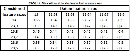

Each cell in the table for case D can be expressed mathematically as (T+B+S)/2, where:
T - the tolerance value specified in the feature control frame (which is 0.4 for all cells).
B - the available bonus tolerance (which is a difference between the 'considered feature size' and the LMC size (23.5) of the larger diameter).
S - the available datum feature shift (which is a difference between the 'datum feature size' and the LMB size (11.8) of the datum feature).
So the value in cell [24/12] comes from: (T+B+S)/2 = (0,4+0,5+0,2)/2 = 0,55
And the value on the diagonally opposite side of the table in cell [23,5/11,9] comes from: (T+B+S)/2 = (0,4+0+0,1)/2 = 0,25

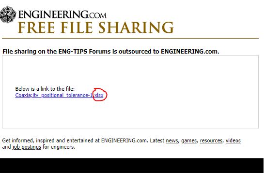

Also, Season Lee's example appears to have a non-URL character in it making it not down-loadable.
3DDave said:
Still has a semicolon in the filename.
If you are able to download the file (I am) and knowing what the extension of the file is (.xslx), just manually add the extension to the file name and this will let you open it.
