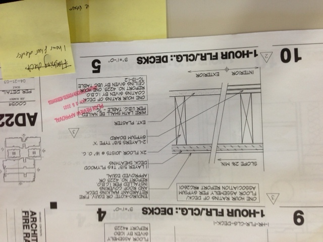

Nevertheless, from the photo posted above, it seems rather obvious that the cantilevered joists were pretty deteriorated from rot caused by water infiltrating into the building envelope and that rot was a significant contributing factor to the collapse of the balcony.

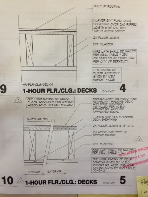

does anyone believe that the gypcrete was placed at 2% slope per plan and that it might had inadequate slope or even the wrong way? water test might have been useful to see if water actually drains off the balcony.

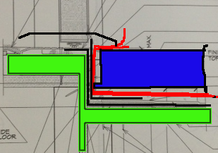

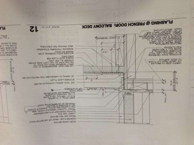

3. The statement above that the flashing should have been turned out above the topping slab is wrong. The topping slab is for protection of the membrane, not to serve as such.

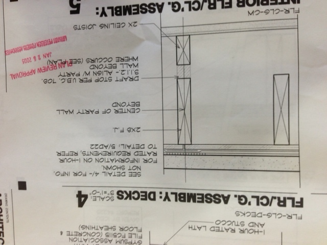

cvg, Who puts gypcrete on an exterior balcony?

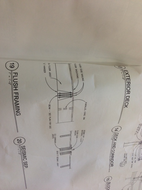

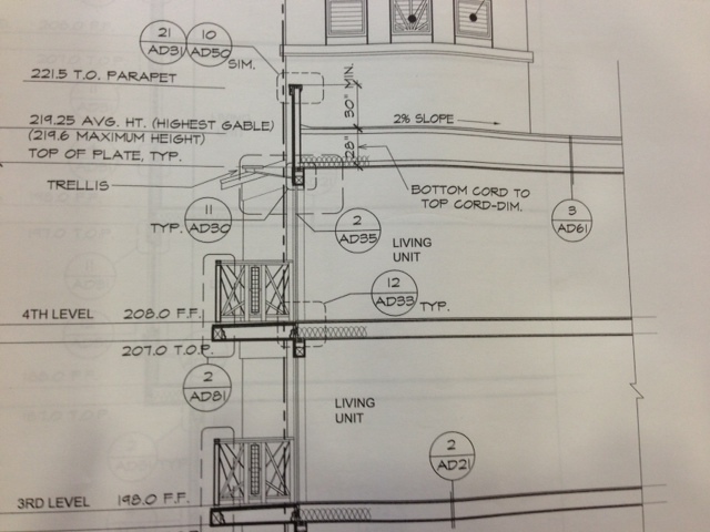

(Despite the somewhat unclear plans photo, I will weight in on what seems to be a problem so designers will avoid it.)
That drawing seems to show a saw cut top chord of the cantilever lumber. This would probably change the grading of the lumber and if pressure treated, would remove the treated wood and open it up to moisture intrusion. It also opens up endgrain right at the area where the flashing most likely leaks at the face of wall.
The slab doesn't protect the membrane, which stops a large distance before the wall. In fact, it stops just about where the wood rotted. The slab does serve to funnel water that runs down the wall directly to the open edge of the membrane. Had the membrane been continued and terminated under the door sill above the concrete, there would be no opportunity for water to get under the membrane and from there to the wood.

Here's what I'm looking at - in the first I've exaggerated the positions; I think the filler board will eventually get compressed, and not rebound, leaving a gap and with it a reservoir of water. In any case, it cannot form a bond with the concrete, so water will bypass it and be directed as shown, with the first place it contacts the wood in the offset of the barrier where the moisture barrier doesn't exactly follow the flashing, leaving at least a small reservoir of water that cannot evaporate, but will be consumed by fungus to drive rotting.
The next shows the moisture barrier under the metal flashing, protecting the potentially exposed portion of the barrier. The barrier is continuous and water is prevented from contacting the wood, while being able to be absorbed and evaporated through the concrete.
Some details are omitted from both images - the filler board, the caulk, and the door details.
