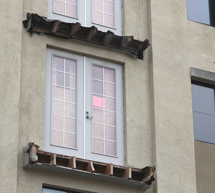

ChiefInspectorJeff showed us a framing plan purporting to be of the building in question. It appears that the balcony joists are cantilevered with a fairly small back-span but I tend to agree with hokie66 that it isn't relevant.

My point in asking about the type of construction is that the posted article seems to indicate that a more redundant system (where all of the joists are cantilevered) would be safer. However, from what I can see, all of the joists do appear to be cantilevered. In my opinion, this type of sloppy writing misleads its readers and is not useful in our pursuit of learning from past mistakes.
BS2: "All the joists appear to be cantilevered." I would like to know what leads you to that conclusion.
Found the pic I was referring to. This pic is what led me to think that this is an outrigger system. If anyone has more information on the type of framing system employed (a pic of the structural drawings showing the framing system would be ideal), please feel free to post it on this thread.

I agree with BS2 that the joists appear to be cantilevered. What leads me to that conclusion is the photo of the failed joists. They all failed at the exact same location along the span as the two edge cantilevered members that are larger in cross section (i.e. the two you refer to as outriggers). In the system you refer to as an outrigger system, I assume that you are implying that only the two edge members are cantilevered, and that the infill joists are simply supported spans between a ledger at the exterior face of the building and an edge beam spanning between and perpendicular to the two cantilevered outriggers at their free ends. If what I have described is an accurate description of what you refer to as an outrigger system, then I don't think that the infill joists would fail in the manner that we see in the photo. Don't you think they would fail at the simple support at the ledger at the face of the building?, especially if it was a toe nailed connection, which it would have had to be since we don't see any joist hangers at the face of the building. I don't think this is the system that we see in the photo. They clearly look like cantilevered joists to me.
I agree with gte, they are all more likely than not cantilevered. I often put in a bigger edge beam because it makes other things easier, like connecting guardrails and such.

I fail to see how everyone on this thread concludes that these joists are cantilevered. These photos can only give us certainty that these joist bear upon the wall; there has been no means presented on this thread that can suggest that these joists extend beyond the wall - a backspan - to another line of support. Indeed, we are only looking at photos taken from the outside of the wall.
Yes, the stubs remaining of these joists have not significantly rotated as a result of the failure, and that does suggests some measure of restraint to keep them somewhat horizontal; however, there was not much strength left in these members to cause such a rotation at the moment of failure.
We have a lack of information, gentlemen, and we are jumping to conclusions. Again, all I have to go on - as shown on the pic I have posted above - is that the outlying "joists" are thicker than the other joists. This leads me to the likelihood (not certainty of course) that these are outriggers. Why else would these members be thicker than the others?
So, yes, of course I may be incorrect in stating that this is an outrigger system. But the point of my article was NOT to insist on this, rather, to suggest an opportunity to explore two types of balcony construction.

With respect, I think you are the one who has jumped to conclusions, and placed your conclusions in an article for public consumption. Did you see the framing plan? It seems to show cantilevered joists, but that is just my conclusion. A cantilevered balcony is a cantilevered balcony, no matter how many members cantilever.
No I haven't seen the framing plan, hokie66. So, please, if you can, post a pic of the framing plan.
Richard L. Flower, P. E., LEED Green Associate
Senior Structural Engineer
Complere Engineering Group, Inc.
In this thread, ChiefInspectorJeff posted the framing plan 23/6/15, 2311. Not very clear, but I think it shows all the joists cantilevered.
Thank you hokie66. I see that it was posted three days before the article was posted; however, I wrote that article on the 23rd. Had I realized that the floor framing plan was posted, I would have reviewed it before writing the article.
So, yes, that is a true cantilever system rather than an outrigger system. I was fooled by the larger members in the pictures. The joists were "ripped" to allow the shallower depth required for the concrete deck on the balcony.

There are 2 balcony framing types. One is joist supported on each end by hangers.
The 2nd is the type that collapsed which consist of cantilevered from an inset inside the floor edge lam beams and between them non p.t. joist.The blocking at the interface of the building makes it hard to see the inset joist.
My theory is that the stucco leaked into the wall from an area about 16' high and with no deck above to block the rain dripped into the wall behind the flashing and floor membrane.Also flashing nails are highly suspect.
I see no weep screed at the base of floor 5 to drain water.
Also the membrane looked short and not going up behind the metal flashing on the detail at the door.It also looks like the decay occurred at the membrane lap.

I've been following this from the start and is the below a reasonable summary of what the forum has found / posted / noted?
1) The balcony was designed and built from non pressure treated wood as a cantilever design with no significant level of redundancy
2) It was highly unlikely that it was designed to hold 13 people in a 6 x 4 space even at new condition, but no notices existed to that extent
3) The failure of ALL the beams at seeming the same location close to the building indicates a failure of the water proofing, the details of which are seen in posts above
4) Confining the wooden supports within a structure which did not allow either inspection or drainage of any water entering the envelope is poor design
5) Placing a 2 1/2" concrete screed above the beams is not a good idea
6) Similar structures are recommended to be either removed or inspected to show adequate strength of the beams on a regular (1/2 year) basis, especially for those locations where there is no rain cover above them
7) Load limits should be noted / posted on similar balconies
8) More info to come from the scene in due course
9) Any structure where collapse could lead to human deaths must be designed with sufficient redundancy so that it does not collapse when any element fails.
