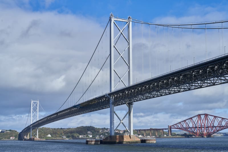

Curiously, the extremely similar Forth Road Bridge was upgraded in 1999 with a series of linked cofferdam cells filled with rock and capped with concrete. There's considerably less ship traffic on the Forth than in the SF Bay. Most of the traffic is much smaller, with the exception of the occasional aircraft carrier. The steelwork of the towers was considered non-redundant and vulnerable to impact from a ship in a 1995 report; I don't see any additional redundancy in the main towers of the Bay Bridge.

I love the Firth of Forth bridge in the background. I believe its predecessor was the subject of "Engineers of Dreams".
The caps on the Forth Road suspension bridge do not appear to provide enough distance for the overhang of a ship.

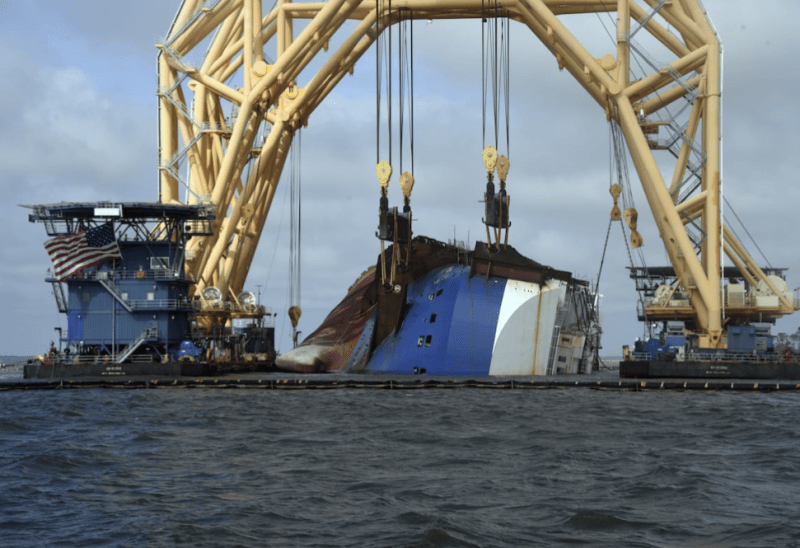

They can saw it with a chain. See *Golden Ray" for an example.

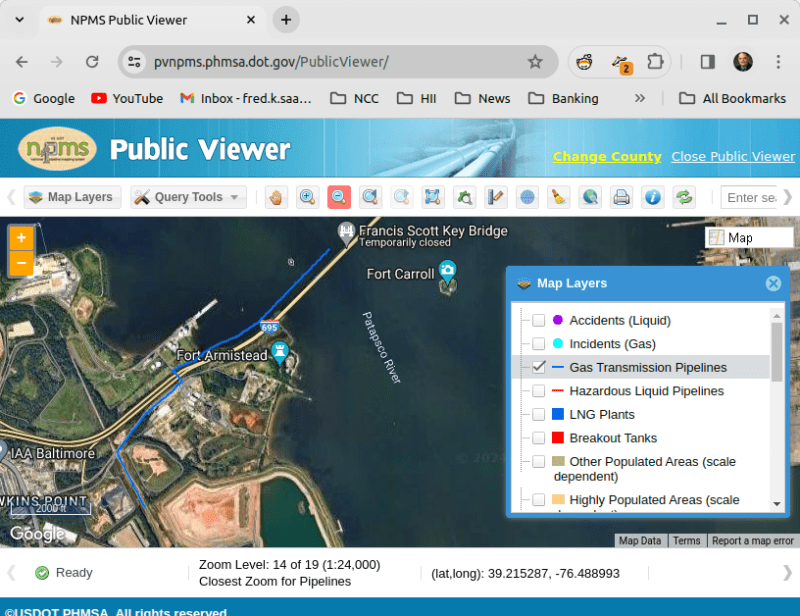

We are not yet at a point where we are just chopping up scrap for the recyclers. Cutting steel trusses with any method must be done very carefully and with consideration for where those pieces that are under tremendous tension may land. The survey crews were already there on the first day to map out the exact location of the 24" gas main that parallels the bridge. They will not be using explosives or giant metal snips without doing a bit of homework on the potential for making the situation worse or endangering the people that are doing the work.
They are adequate for the typical ships which go upstream of the bridges, designed in the late 1990s and the shipping traffic hasn't significantly changed since then. The original bridge piers were considered strong enough for ship impact, with the upgraded defences being specifically for the expected overhang of ships using the river. The ports upstream are quite small, compared to the massive container ports elsewhere, and the river channel is relatively narrow and shallow. The exception is the Queen Elizabeth class carriers, but they are maneuvering slowly at that point and have tugs to assist them.

Seems there is a HP gas line under it all.

A large diameter high pressure gas transmission line (BG&E) was found to be very close to or underneath of the grounded ship, this has delayed attempts to Salvage the MV Dali
