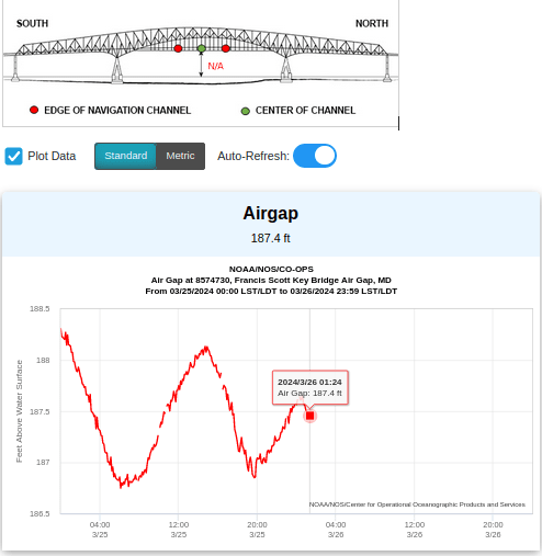

Anyone have any info on the tidal currents in that harbor at the time of the accident? They can significantly affect navigation.

NOAA tides and currents shows winds < 10mph
The display of space under the bridge indicates the tide had just turned and at the time of the last data recorded - same time as the collision. Nothing unusual about the weather.
