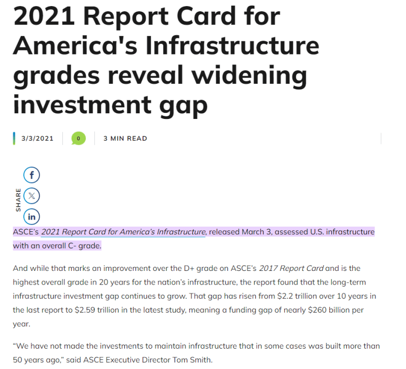

I think the lack of dolphins or other protection at the piers would be part of the reason USA infrastructure gets a C-.

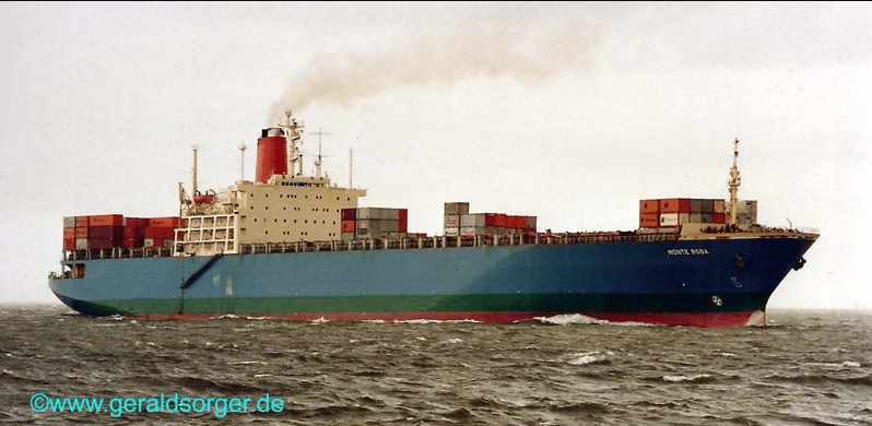

I doubt designers in the 70's envisioned a modern container ship. Here is an image of a 1977 container ship. I am not much of a mariner, so they could have been larger than this.
