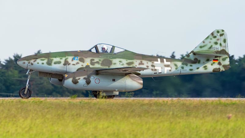

I always thought the Me-262 must have had a serious nose-up tendency due to the position of the engines.
