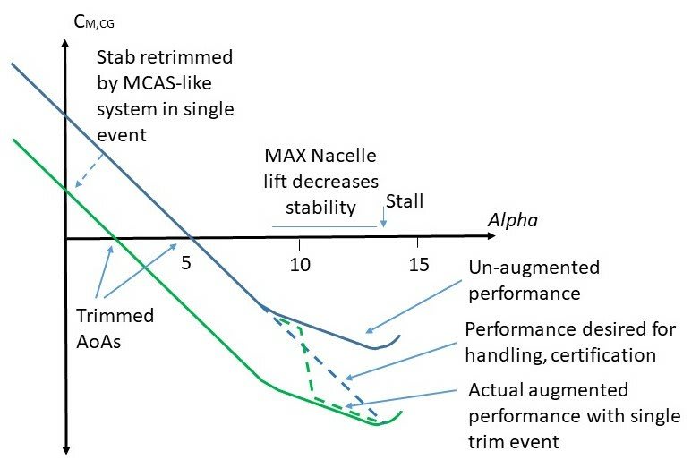

Now the reason why they had to have the MCAS system. The leap engines are extremely effecient. We had 737 classics fleet and also CS300 fleet the CS fleet uses 1600kg of fuel an hour the 737's its 2400 kg an hour. The fuel savings are collosal. The leap engines are a geared fan and the fans are huge. This means the engine pod is huge. So when they fitted them to the NG wing they didn;t have enough ground clearance. SO they raised the gear height and to get more room the moved them forward and up.
737 800
737 max 8
now if you look at the shots above its pretty obvious the geometry changes that have needed to be done.
The leading lip of the nacelles if significantly forward of the leading edge of the wing on the max.
Now what's apparently happening is when the aircraft gets into high angles of attack the huge pods which have a flat base are generating lift and because they are so far forward of the centre of lift of the main wing they are forming a moment couple in addition to the elevator. This has the effect that as the angle of attack increases the control force decreases as does the stability. This is completely against certification rules. As you get closer to the stall the control forces should increase and the stability increase with the aircraft having a natural inclination to lower the nose to decrease the angle of attack. In all cases in the event of a stall in straight and level flight if the pilot lets go of the controls the planes stability should mean that it self recovers ie the nose drops and the angle of attack is reduced.
This wasn't the case with the max with those engines. So they stuck a computer fix in that altered the trimming of the aircraft to produce forward trim as the angle of attack increased. That in itself I don't have a problem with really. What they didn't do is then complete the risk matrix to look at how the Angle of Attack is measured and the failure modes. We tend to have three of everything for critical systems.

The MCAS took its input from 1 AoA sensor of which there are only two fitted so no way of determining the odd one out in the event of a failure. No comparison indicator warning on the flight deck as standard between the two sensors. All other critical flight instruments again follow the rule of three. And all the rest will trigger comparator warnings if there is conflict in the readings, then the pilots can look at the separate system and two out of three win and the faulty reading can be deselected.
Realistically I can't see a fix for the engine lift issue without a complete redesign of the wing and aircraft geometry.
