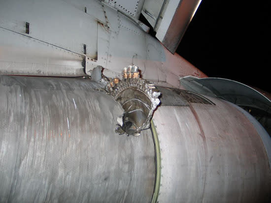

Hardly - but if you are talking about turbine disk rupture then nothing on the plane is capable of stopping that debris. Worrying about engine position is a bit wasteful.
If you have a particular instance that is applicable to the 737 then bring the research.
The only control runs getting cut due engine failure I can think of is the soux city trimotor crash. Which is a completely different situation to the 737.
I can't see how you could protect against the hub going through the hull.

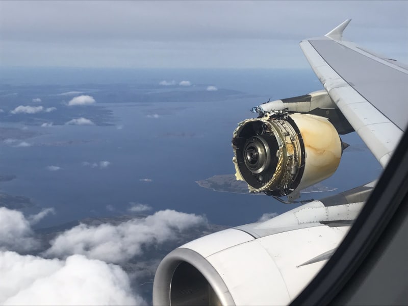

the fan blade detachment and bird ingestion tests are the same as always. if the main hub comes off the shaft there is nothing going to stop it departing. Even in the RB211's that they use for power generation which aren't subjected to the same maint as the aero ones it basically rwrecks the whole generation house when they go. I think one of them managed to punch through the whole of an oil rig when one of the rear turbine disks separated. They never did find it.
its this sort of failure they are on about.
or this
Which is a airfrance A380 where the hub sheared off and they have recently found it under the snow.
