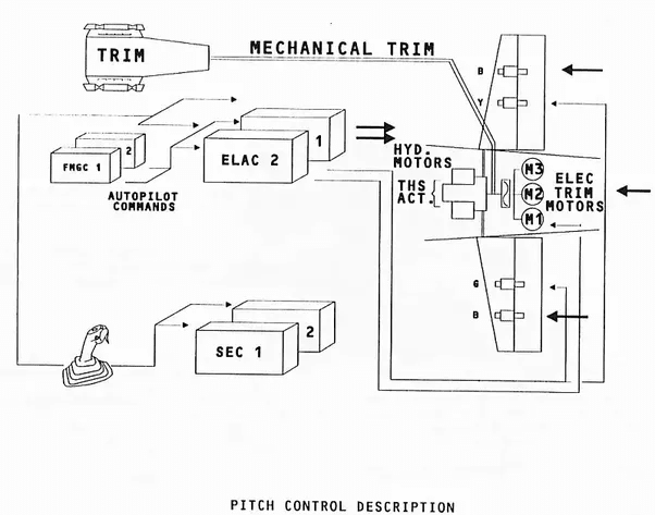

The Airbus wheels don't require force just like the control sticks don't. They could have used paddle switches, but used fake wheels instead, no doubt as a cost savings measure for compatibility with training on some long extinct type.
Just confirmed it on the airbus there is definitely a mechanical linkage to the trim stab setup.

All the Airbus cockpit photos show only a tiny portion of a wheel exposed. So lets get an Airbus to full nose down trim and see how easy it is to move the wheels.
Extremely easy. Until you get all the way down to mechanical backup. And even then there is power assist on it aka power steering on a car. So you would need a failure of all three hydraulic systems and no electrics to turn it into a 737 max.
Finger tip stuff.
Even in dual engine failure with the RAT out you don't go to that law.
Its only there to give you control while the electrics come back online and the computers come up. You can't land using it.
Gotta be full failure. So I guess that's a nope, the trim wheels won't help. If the software fails from cosmic rays bashing a bunch of bits, so be it. Ground Airbus until this is a dealt with.
