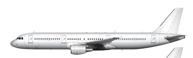

The profile of the 321 implies the jet actually skidded along on the engines... The right hand engine does appear to have come away at the last minute.

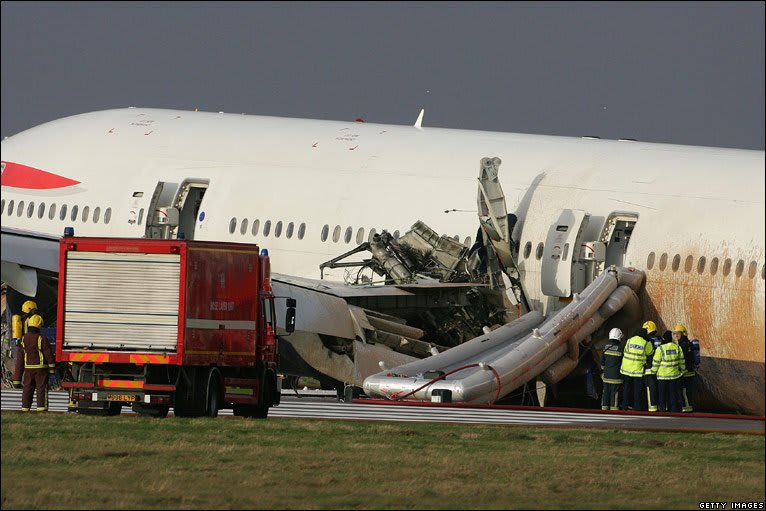

Here is a pic of the 777 at Heathrow where you can see what happend to the gear. And my mate was working in the tower when it happened as an ATCO. We still give him stick about it.

that pic is my point - gear down damage could easily rupture fuel tanks or end up in the cabin. The right hand gear set detached.
It looks like there were recommendations out of that crash about what happens to the main landing gear to try and prevent fuel tank rupture, but leaving the landing gear up would be one way....

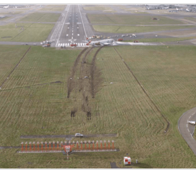

If you look at the skid marks I think the engines did most of the slow down.

Anyway someone did the calcs and reckoned with out the main gear going up through the main spar it would have been over 8g touch down or some such magic number which would have meant the floor seat mounts collapsed with a 85kg adult in them. The plane did its job and everyone survived which is the main thing. They were also lucky it had been raining a lot.
