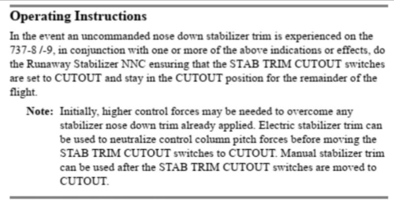

"The AD is clear. Trim the airplane before shutting off the motors."
You are incorrect on both points.
It actually emphasizes ensuring that the STAB TRIM CUTOUT are set to CUTOUT first. Later, in a note, it allows what would be a contradictory back pedaling to switch the system back on.
You may review it here.
Extracted from report.
This unclear and out of order wording will almost certainly be a point of discussion in the final report.

First, MCAS cannot be shut off because it is to meet a requirement from the FAA. This is particularly true since it is to operate when all other automation is shut off to discourage pilots from approaching stall under manual control. It's like a switch that disables ABS on a car. See any cars with that switch on the dash-board?
Being able to shut off the trim motors at all has been a point of contention. There should never be a need to shut MCAS off; had there not been a false AoA detection MCAS would not have needed interaction.
Second, MCAS is a software overlay on the Speed Trim System. It's not a separate thing. There's no MCAS unit in the plane so MCAS has no individual shut-off. It can be overridden using the electric trim switches. That was known as soon as the Lion Air report came out.
While the instructions are out-of-order the steps presented are not.
"Electric stabilizer trim can be used to neutralize control column pitch forces before ..."
"Electric stabilizer trim can be used to neutralize control column pitch forces before ..."​
Emphasis mine. CAN is not MUST. It's an optional item of the checklist. Skipping it is also a valid (if stupid) choice, and can't be used to say they didn't complete the checklist. Turning electric trim back on can be, since that's not an optional item. But the AD did not require returning the aircraft to an in-trim state using the electric stabilizer trim switches. This is a flaw in the wording of the AD, and probably contributed to confusion.
The AD isn't a checklist...
The pilots should have been looking for clarification if the AD working was so confusing that the pilots didn't understand it. After all, a plane of the type they fly just crashed and Boeing released this AD to help clarify how to save the plane the next time. Overall, I suspect they didn't much care, at best gave it a cursory read, and carried on.

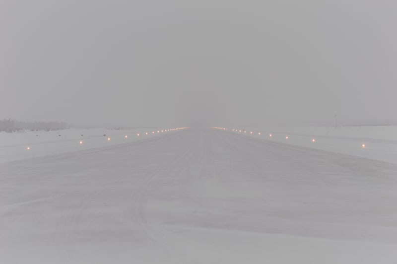

In Europe you have a button to turn off ABS.
The main reason for it is because heavy snow and ABS are not a very good idea especially with studs on.
Alot of Northern countries run white roads and runways in winter and have a compulsory change over onto winter tyres.
A normal runway condition in the north of Sweden.

Odd though, because ABS was originally designed for aircraft to handle runways exactly like that. I still see no indication that there is an option to shut it off specifically in the European market. I did see one reference that very old Audi's had a switch, suggesting that it was removed sometime between 2003 and 2005.

I deleted my comment earlier since it seemed to be going farther off topic but the ABS can be turned off on the Tacomas and most 4x4's I'd suppose by engaging 4x4 or the E-locker. If not disabled offroad, the ABS system would be going off continuously every time you engaged the brake on soft/loose soil and possibly risking burnout I'm guessing. It's really not needed or effective offroad since the tires can effectively brake in soft soil by plowing action or friction even if the wheels are locked up since the tread is engaging the full internal shear friction capacity of the soil/snow which is the maximum resistance you can expect.
The Scandinavians hate ABS in the winter. Its not actually to improve braking its to allow you to steer while braking. As Charlie says if the road surface is low friction it creates all sorts of issues.
