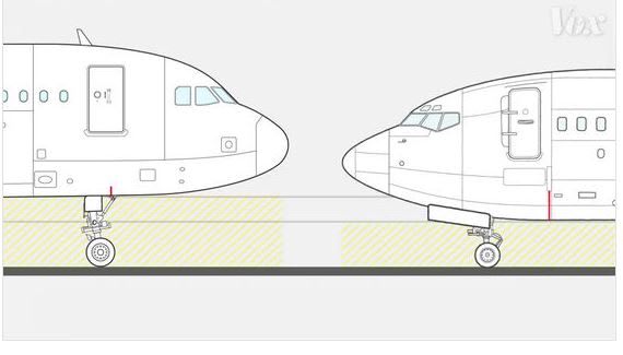

I can see you like that solution, but the magnitude is large.
From what I can gather the 737 would need to be higher in the order of 600 to 700mm.
That's an awful lot of extension.
Picture is the difference for A320 to 737
