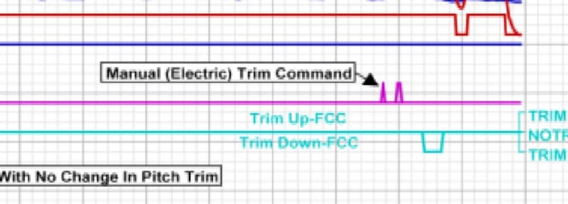

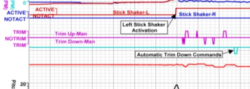

"...FDR does not record pilot input to trim via the thumb switches."
The Preliminary Report for ET302, in Appendix 1 'ET302 Preliminary FDR Data' (page 26 of 33) shows a purple trace marked "Trim Up-Man" and "Trim Down-Man".
The near rectangular shape of the waveform and surrounding context seems to imply it's the thumb switches.
But perhaps I'm misinterpreting it; so clarification always welcome.
Extract:
Edit to add: Perhaps the Manual Trim data is derived from the other data. i.e. Jack Screw actuated and not Automatically, so it must be a Manual command. Pure Speculation Alert on this.
Other side of the same chart confirms it's:
"Manual (Electric) Trim Command".
Extract:
Is it possible the manual (electric) trim command lines we see are just the processed outputs?
Yes, that's possible. My edit above offered such a scenario.
"Perhaps the Manual Trim data is derived from the other data. i.e. Jack Screw actuated and not Automatically, so it must be a Manual command. Pure Speculation Alert on this."
If the system designers were running out of FDR input pins, they might quite reasonably decide to prioritize the Jack Screw over the Thumb Switches.
Obviously actual facts will take precedence over such speculation.
