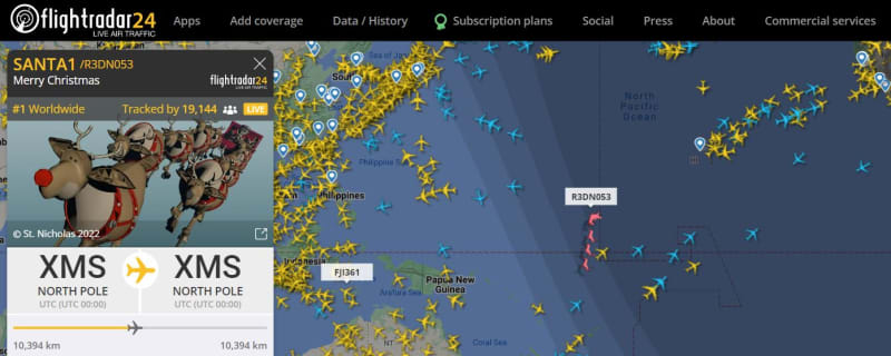

NORAD for years have done an excellent Santa tracker
They go to serious effort with it as well.
[rofl]
