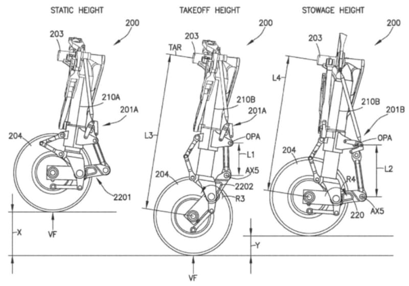

It has been stated that modifying the landing gear would require redesign and re-certification.

By the way, I understand that the MAX 10 had extending landing gear.
Did the MAX 10 require simulator training because of this?

That extending leg on the 10 was only at rotation and touch down. Once the full weight came on it was the same height as the normal planes.
It did have some fancy linkages to pull the wheel back to the same length as the normal ones when it retracted but it wasn't a fix for the larger engines.

The landing gear cannot be changed for multiple reasons, but the gear was changed on the MAX 10.

its not really been changed.
The bottom is on a lever arm so it extends 25cm during take off to help with tail strikes.
