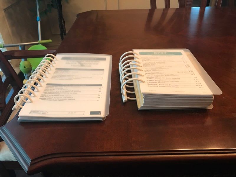

The main issue I was on about is still using a 1960's caution warning system with paper QRH on a modern full EFIS flight deck. They should have tackled that with the NG never mind the MAX. There should be a time limit/upgrade limit for new tech. eg 10 years time you have to have it on any new models on a type cert and you can only have 1 iteration during that time. So if you went 717-200 to 400 with a 300 released in the middle then the 400 would need the tech. If you released the 717-300 after 6 year it would be able to use grandfather. Type approval on year 11 and they need to have it. Basically its only a period to allow projects which had started before the rule came in to complete.
This picture shows a Airbus QRH on the left and a 737 max QRH on the right. Dark stormy night day 6 of 10 hour days sector 24 which one do you want your pilot dealing with at 3 am in the morning? BTW the Q400's is half the thickness of the 737 QRH and its still a pain finding the right page.
