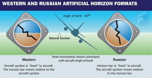

There are two forms of artificial horizon out there.
It has been shall we say rather painful and deadly converting pilots between the two methods when they have been trained initially using one method.
I have flown aircraft with a Russian artificial horizon but very quickly it was screwing with my head even though i was looking out the window. It was a good learning experience.
After 5 mins I covered it up and only used the window and I certainly would never attempt to fly on instruments using it.
Its not so much an issue for none Russians because they will never have used it. But Russians converting onto western hardware such as Boeing or Airbus it must be a mind screw for years.
I believe these days young commercial pilots in Russia don't go near it.
