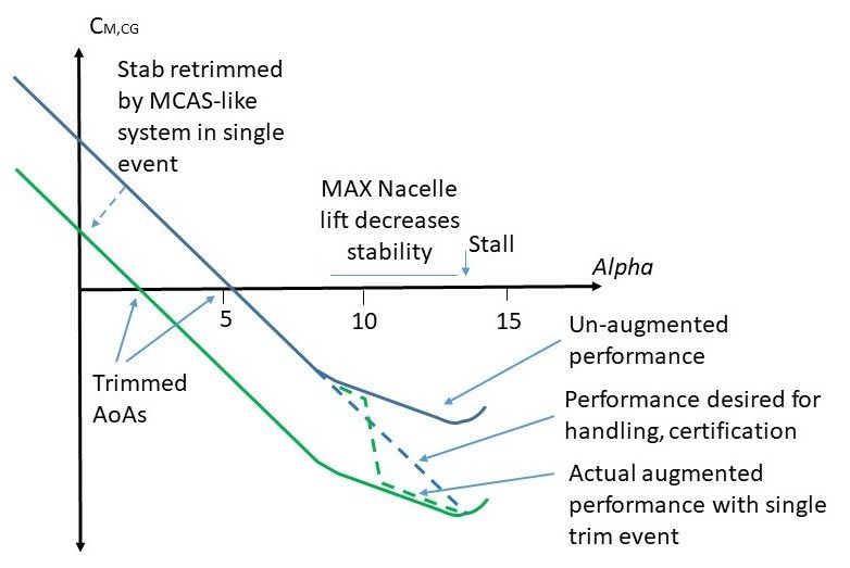

It helps to return to the graph that was posted back in about April 2019.
While I can't find the original source or how the details on it were created, it matches the problem as described by Boeing and repeated oh-so-often in the media as it relates to pitch forces. There are popular graphics still being republished in the press that get this wrong.
The chart plots "Cm,CG" which in the flight-control context means "Coefficient of pitching moment about the Center of Gravity".
It relates to the proportional force on the control column that you need to push/pull to maintain a steady angle of attack, with all other conditions in equilibrium (enough power to maintain constant altitude and speed at the same time).
The desired response of the aircraft is to resist an input force on the control column with a reaction that returns the aircraft to the stable condition, which is called "trim" in aviation. When the reaction is the opposite of the action, the "feedback is negative" so to speak, and that makes the result of the force balance negative. That's why the line passes into the negative region of the curve.
What the regulatory officials said - in these terms - is that "the Cm curve does not cross over the X-axis". If it did, that would be unstable, which means a pull backward on the controls would lead to the nose constantly going up without self-correcting. So what Patrick Ky and Steve Dickson said was that it doesn't go run away from you. They are probably aware that the popular press has exaggerated this often. The regulators probably felt that once they had experienced the control responses for themselves, they could make a statement to counteract the mistakes made by the press.
The spokespeople later had to clarify, because it seemed to undermine the need for MCAS at all. In closer detail, there isn't an instability being addressed by MCAS. However there is the tendency of the restoring force to level off at high angle of attack. That's the solid blue line in the chart below. For the forces to seem relatively constant over a range of angle of attack, even though they are pushing against you as you pull up, they aren't giving you the "feel" of nose pitch up because the force doesn't increase much. The restoring force should increase as you pull more and more away from the trimmed condition. This takes us down to a finer level of subtlety. I would like to know if it is really perceptible by a pilot when MCAS is off, or just measurable with flight test instruments.
A much better technical explanation. Really is only that last little uptick that looks odd.
So both statements are true but not many will actually understand the difference.
From that uptick took up at the at the horizontal line.
That is the stall point.
Do I read that graph correctly Spar?
One cycle of MCAS will bring handling characteristics into regulatory compliance out to the stall point?
From that graph, it would seem as if one cycle of MCAS would be all that was ever needed to counteract the uplift.
From the graph it would seem as if any further increase in AoA after one action of MCAS would be due to reasons other than nacelle uplift.
Are there other factors that are not apparent from the graph?

We're heeerrrrreeeeee:
Canada said on Monday it will lift a near two-year flight ban on Boeing's 737 Max on Jan. 20, joining other countries like the United States that have brought the aircraft back following two fatal crashes involving the model.
Sadly so, and even I've fallen victim to the verbal short-hand of mistaking a measured force gradient for the force itself in various conversations. It's like hearing the same lie enough times to believe it. In this case, not a lie, but a mistake misspoken enough times that it confuses the real details. Heck, I should also repeat that I still haven't found the origin of the chart I'm using as an illustration of my argument. As such, there could be other errors or oversimplifications in it that I'm not noticing because I'm not paying attention to anything but the trend on it. So Waross's follow-up questions are no surprise. Actually, the point where the chart passes the point of zero Cm, over 5 degrees, is a bit high. The plane would not have that much nose-up attitude unless it's at max gross weight. Although, on second thought, max GW is a common point of reference for aerodynamic parameters, so maybe not so strange. I think the stuff on that chart is square with reality, I just can't prove it.
