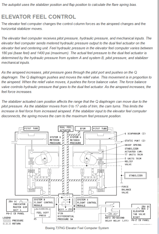

Feel diff pressure
Its to do with the hydraulic systems and the force feel system on the elevators. There is power assist on the controls, the feel system applies a force onto the controls which varies with the amount of input aerodynamic loads airspeed
and a few other things. So the more you pull the more more force you feel. Faster your going the more force there is for a given deflection.
The feel computer can use either A or B hydraulic system and when there is a big split of pressure between the two sources it illuminates that light. Quiet how that would be triggered by a faulty AoA sensor i really don't know. I suspect its unrelated.

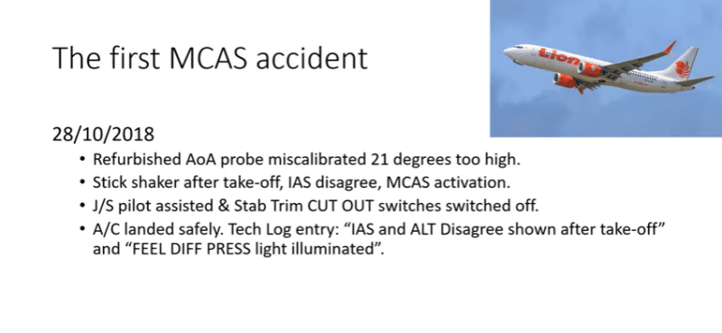

right found out about this Feel diff pressure.
Its a known issue which hasn't been fixed since the feel system was originally certified back in the 60's. But they never bothered fixing it. There is actually a surprising number of "funny's" that have have never been fixed.

I assume that this is done to give you the same feeling as if you where flying an all mechanical system.
Without this feedback system you would not have any sense of the forces that are acting on the plane correct?
I also think that this feedback pressure for the the force feel is a calculated value.
Because you can not get a force feel value back from the hydraulic system that controls the angel of the elevators since it is kept in the same position as you want it regardless of the speed air pressure that it is exposed to.
If the force feel is a calculated value, one way of doing it is to take AoA value and combine it with speed and the angel of the elevator, and from this tree calculate the expected force on the elevator that you would have felt, if it was a all mechanical system.
And then the calculated force is feed back to a the controls.
And if it was as in the first crash that one AoA was wrongly calibrated.
The calculated force on the left (A) and right (B) side would have been different.
When compared that would have lit the FEEL DIFF PRESS lamp..
As explained in the video, the left side AoA was connected to computer 1 and right side AOA was connected to computer 2.

There is a link from the stall system to the electronic feel shift module EFSM.
I can only presume that when the stall system is triggered by the dodgy AoA reading it does something to the feel system.
This is pure speculation though.

Your link says this about the force when a stall is thought to be occurring. This says it increase the"feel" by a factor of four....
The elevator feel computer has a feature where it creates four times the forces to pull back on the column than normal.
When the stall identification function is trimming stabilizer nose down...
(with the thinking that this is a stall recover, believing AOA perhaps erroneously, and assuming that engine thrust is going to increase rapidly),
...column feel forces are designed to fight the pilot pulling back on the stick (to encourage the nose dropping), and also to avoid the pilot tripping the column stabilizer override switch if they pull it back far enough.
Sound sensible LI
So not only did the pilots have it out of trim when the MCAS triggered but they also had x4 feel fighting them pulling the stick back.
