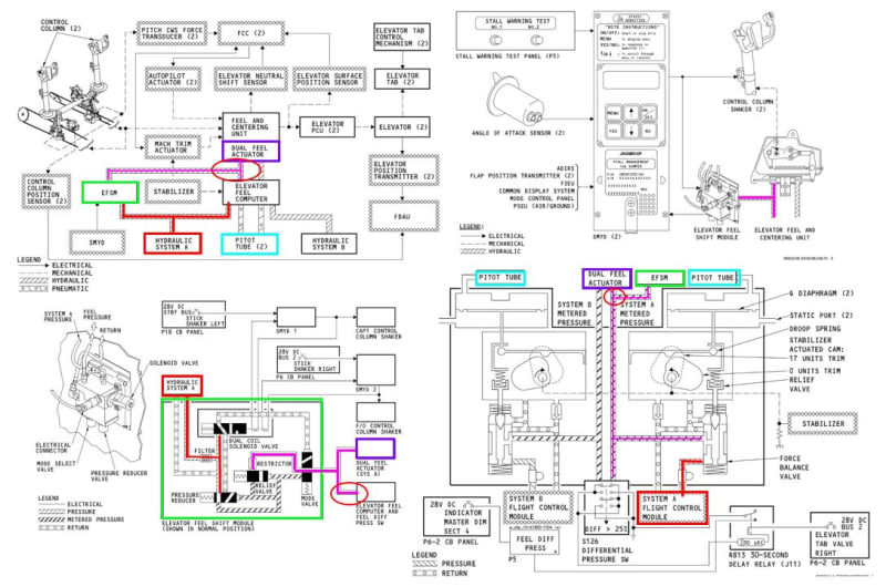

Inherent in both the Flight Control Computer (FCC) and Stall Management Yaw Damper (SMYD) is the angle of attack sensor, or AOA sensor.
The AOA sensor data is used to determine airplane pitch attitude to set the stall warnings and to calculate performance data.
Amongst the many analog interfaces, the Stall Management Yaw Damper outputs discretes for stick shaker and to activate the elevator feel shift module.
Each Stall Management Yaw Damper activates its on-side stick shaker motor.
When airspeed is close to a stall, the Stall Management Yaw Dampers do the Elevator Feel Shift (ELF) function by operating the Elevator Feel Shift Module EFSM which provides 850 psi (58 bar) hydraulic system A pressure to the elevator feel computer and the dual feel actuator.
This causes the elevator feel force in the feel and centering unit to increase and to counteract or resist elevator up movement at the control column.
Activation of the Elevator Feel Shift Module occurs at an AoA of 8 to 11 degrees depending on flap position.
There are no other flight deck indications when this system operates.
And the reason why the FEEL DIFF PRESS lights up is that since it is only hydraulic system A that provides pressure to the elevator feel shift module and it also provides pressure to only one side (channel) of the elevator feel computer when the SMYD dual coil solenoid valve is turned on the pressure difference between channel A and B in the EFC:n becomes more then 25 bars and then the the FEEL DIFF PRESS lights up after 30 sec.
And one AoA was calibrated wrongly 21 degress the first crash.
And it is enough that one stick shaker motor activates for this to happen.. as I see it..

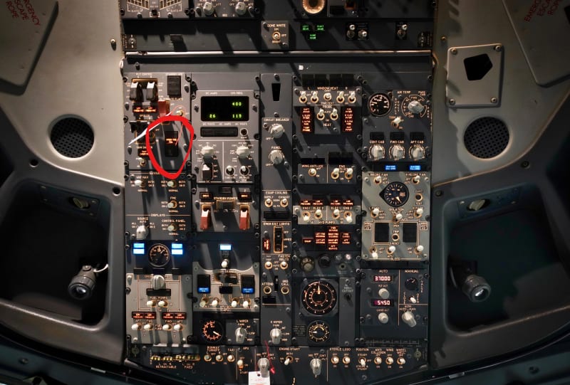

Just so you have a reference this is the max cockpit
And this is the flight control panel. Which is located in the top left of the photo above most of it out of shot I think.
[ponder] [hairpull2] [bugeyed]
Albert Einstein
you think that's bad here is the CB panel. The ones with the collars on them are the ones that need to be pulled in various checklists. I don't have clue where the stick shaker CB will be. But with all of them someone will have to get out of their seat to pull it.

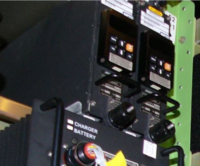

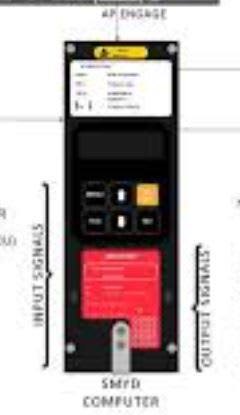

I cant really see anything on the pictures that looks like the SMYD.
I found a reference that says it is located in the E&E bay on the E3-2 shelf.
E&E bay ???
It seems it does not always look the same.
