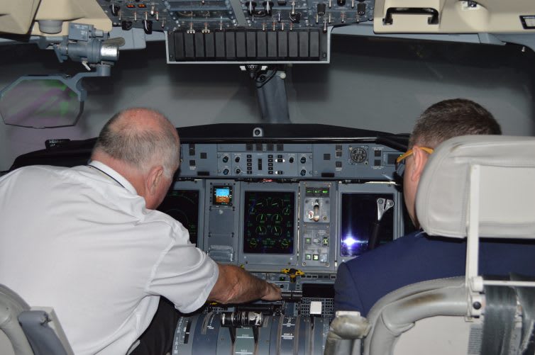

Q400 Hud set up which is right over your head.

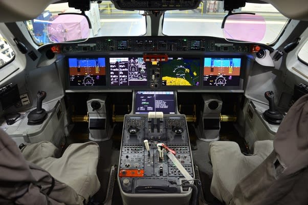

A220 with out hud
And with hud, you can see the projector is behind the back of the seat so your head can't get near it. Even when its stowed away. The Q400 and CJR i presume the projector and screen are one unit forward of your sitting position. We have head alignment balls which we have to line up for CAT II and CAT III approaches to get the eye line in the right place. And for me if my head is in the right place its close enough that my bald head clips the corner of it when there is a sudden G produced in the sim however tight I have my belt. If you remember SAS had multiple gear collapses due poor maint and they added a gear collapse exercise to the sim program which was always enough to batter my head against it unless I took precautions. After one argument about dropping my seat on approach and the examiner freezing the sim and making me put it back. End result was blood pouring down my face from a gash in my forehead. After that they even started telling tall people to drop the seat in the sim only and CAE put a big bit of foam on the bottom of the housing unless it was booked for hud work.

If you look at that first picture there is a silver bit of metal comes down off the bottom, It stays on the bottom when the HUD is swung up away. And there was also a plastic fairing round it. It was that you connected with not the main lump of axle for the reflector.
