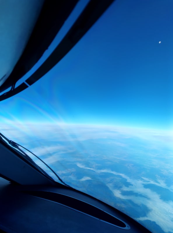

If your interested in the a220 windo looks like close up
Is the diffraction pattern (rainbow) visible to the eye or just your camera that picks it up?

yes you can in certain lighting conditions. And you tend not to see it straight ahead but when you look across the cockpit at the other sides windows.
It also changes with the temperature gradient.
It was a lot more pronounced on the Q400.
I think its due to the heating element grid in the window. Those windows get very hot, a lot hotter than any other type I have flown. Even when its -60 degs outside you wouldn't want to hold your hand on them.

Most airborne optical windows heaters are only designed to provide sufficient heat to keep from frosting, i.e., to keep the window pane at about 5 C or so, which is still makes it close to freezing temperature. For a jet, the power density is supposed to be around 4.26 W/in^2, but that also depends on what the craft is flying through.

There are some of them that the window needs to be warm for bird strikes, the Jetstream 31/32 was like that. If it was cold it didn't pass the turkey test fired at it with big air gun. And it was a no fly if it wasn't working.
As I say this thing is running significantly hotter than anything else I have experience with. The reason why its the way it is I have no clue. There is usually a cold area somewhere in the cockpit which you learn not to put your hand near with direct metal connection to the outside of the airframe on most types. The DV window handle on the Jetstream you would stick to if you touched it. I haven't found one yet on this thing. The floor has electrical heaters in them for your feet in front of the rudder pedals. As you rightly say normally they are just enough to stop them frosting up. These things can melt chocolate.
