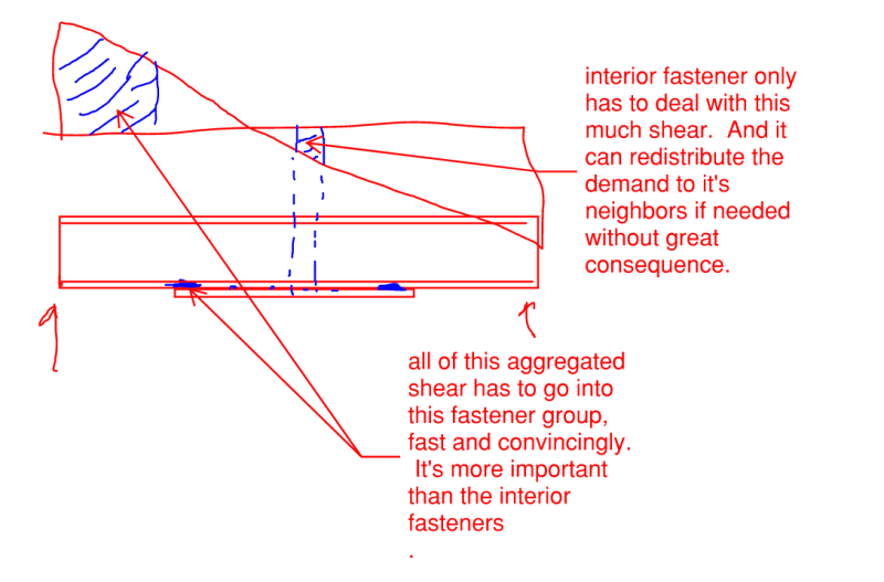

Hello,
We have an existing galvanized beam we are reinforcing partial length with cover plates and we are connecting it with bolts rather than welds.
AISC states that slip critical bolts are required to develop the force at the theoretical cutoff points but does not explicitly state SC bolts are required for shear flow.
My interpretation is that slip critical bolts are required at the ends of the cover plate but the interior bolts used for shear flow do not need to be slip critical - Agree?

A bolted cover plate is atypical, but looks like it's covered in the code. When it's a welded one, the development is at the end, via the end welds and the extension past the theoretical cut off, so the development in a bolted cover plate would be the same thing, would it not?
In the welded case those intermittent welds are prescriptive, aren't they? They don't actually need to transfer any (horizontal) shear force or enforce deflection compatibility between the two pieces because it's a tension force in the plate (bottom flange bending/tension) and it's "fully developed" by the end welds. Why would the bolted case be any different? That speaks to me why the intermittent bolts could be just snug tight. You have to check slip critical bolts for bearing anyway. So slip critical is kind of a "it'll work until it doesn't work" then the bolts go into bearing like a normal snug-tight bolt.
The provisions as written make sense to me. As to what you put on the drawings, well, that's your local standard of care question. Don't slip critical bolts need some kind of special inspection, and even notwithstanding that, if the slip critical bolts are "good" in bearing, if they do slip and or are not appropriately tensioned, surface treatment malfunction, it should still work, at least partially, if not completely with more deflection? We still have that 30" limit on the length of a bolted connection, right?
Last, if nobody mentioned, the bottom flange of the existing beam loses section from the bolt holes.

Still not following, there's the physics of the situation and then there's code, the two aren't the same creature.
If the ends of the piece are designed for the full (tension) force, the intermittent connections aren't physically necessary, they are in there to satisfy AISC code. It looks like the code is requiring two independent load paths for the same force, which is safe, so to speak, without dealing with how the force actually gets into the cover place in a truly theoretical fashion. If it's just intermittent welds/bolts transferring the force, sure, VQ/Ib and the force is zero at the center and maximum at the end.
Never mind, I think I get it now, the intermittent fasteners transfer the load into the plate, the end fasteners transfer the load out. But.... the zero tension force in the center of the plate isn't a physical necessity.
Hokie, if the code specifically wanted slip critical bolts on the intermittent bolts along the length, I expect it would say so. They specifically said slip critical at the ends, after all. If that's already a requirement and they meant it to be throughout, they'd have said it, wouldn't they?
You as a designer can provide them, if it makes you uncomfortable from a special inspection standpoint, or as engineering judgement versus the code, but it isn't explicitly required by the text of the code.

While you've gone a bit awry on some of the details, I don't know that the base instinct with that was wrong.
- If you want perfect, composite behavior all of the way along the beam, then you need the intermittent fastening to achieve that.
- If you only had the development fastening at the ends, and no intermittent fastening at all, you'd still have the lion's share of the desired composite behavior in many cases. This becomes more true the shorter that the reinforcement is and less true the closer that it gets to full span. The development fasteners simply do more concentrated work than the intermittent fasteners do.
In this sense, the fasting of the development bolts is a higher stakes thing than is the fastening of the interior bolts. Since it's rational for higher stakes fasteners to get treated more stringently, it seems to me also rational that the development fasteners get treated more stringently than the interior fasteners.
Just to illustrate why the development fasteners are so much more important than the interior fasteners.
I think that is a fundamental misunderstanding of the anchorage force being developed at the ends of the cover plate. You aren't developing the entire force required in the cover plate, you are developing the force that is in the cover plate at the cut off point. The development fastening won't be enough on its own if you want to have the bottom plate behave like a tie for the reinforced member.
canwesteng said:
...you are developing the force that is in the cover plate at the cut off point.
Yes, that is precisely the larger, shaded trapezoid in my diagram. Although many engineers do develop the full force required in the plate for good measure.

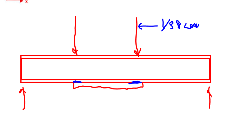

I believe that it will. This simply won't be enough fastening to achieve 100% composite behavior as we normally envision it.
Consider the example show below. Here, you would have full composite action, as we normally conceive it, without any interior fastenings. This is because there is no shear, and no increase in moment or flange tension, between the ends of the reinforcement. Where curvature does not change, there is no demand for horizontal shear transfer.
