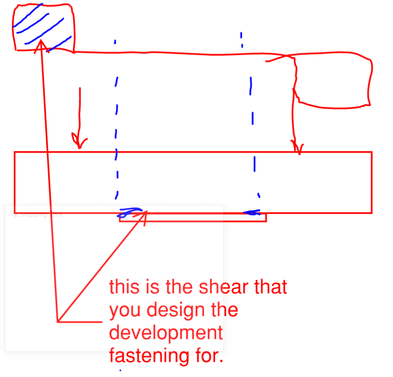

Move the point loads outside and you can see a case where there is no shear at all and you still anchor for MQ/I.
And that is just as it should be. As before, the shear that your designing for is all of the shear present beyond the reinforcement cutoff, as shown below. This is excellent as it's really a more generalized example.

Well, I think terminology maybe is a stumbling block - it isn't that shear you are designing for but the moment, but the moment is the shaded area in your sketch (integral of shear diagram). I'd agree in most practical cases this is going to be the larger force, just due to the nature of cover plates only increasing the moment capacity a fraction of the original capacity.
canwesteng said:
...it isn't that shear you are designing for but the moment...
It is the shear that you're designing for as much as it is the moment. In it's most fundamental form, it is as I've shown it in the sketch below. Your shear demand at development is the missing shear connection that would have been present if the reinforcing had been continued the whole way. And that's the shaded areas under the shear diagram multiplied by Q/It
When we design for moment, mathematically that's just shorthand for the summation of the applicable portion of the shear diagram.
Naturally, in some respect these are just two different, but equivalent, tellings of the same story. Otherwise the math wouldn't work out as it does.

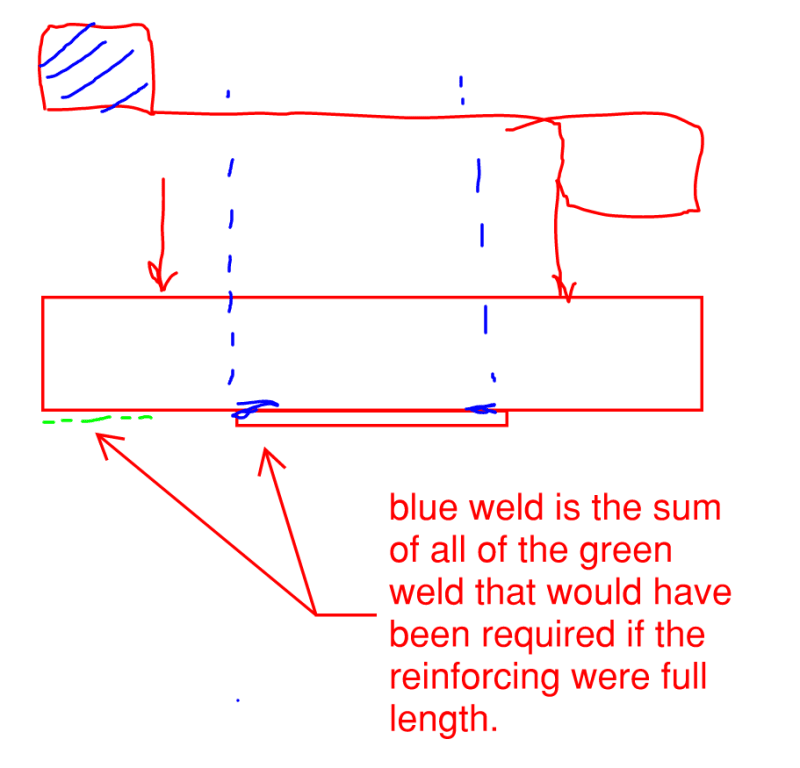

It will always be the larger force relative to neighboring intermittent welds and it will often be a much larger force unless the cutoff is very close to a point of inflection.
It has nothing to do with the plates only nominally increasing moment capacity. The effect would be the same for a 50% increase as for a 5% increase as far as the relative demands on the development and interior welds are concerned.

Well, if the cutoff is at the end of the beam, the force is zero, but the intermittent welds will still see the same VQ/It, so in that case the large force is before the cutoff. You could also get some funky similar situations for continuous beams in theory.
If we have reinforcement that for example triples the moment capacity of the section, your theoretical cutoff is now where the MQ/I term, or shear x unreinforced area, is very small, but you could still have large shear forces. It's not a real situation but if you play with the inputs it could be made to happen.
When the reinforcement extends to the end of the beam, there simply is no development force to speak of and, thus, no meaningful comparison can be made. It's just VQ/It everywhere.

Yes, of course. But, no, that's not what I'm getting at. What I'm saying is that your development welds are going to be working much harder on a kip/in basis than the stitch welds immediately adjacent to them. Your development welds are VQ/It summed over a length. So, without doubt, it is possible that this could be exceeded by some other VQ/It summed over some other length.
