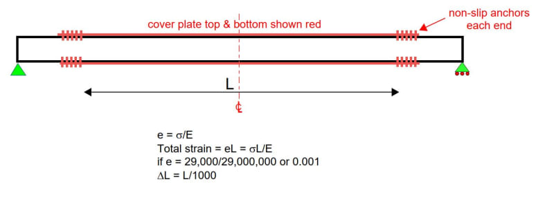

Below is a beam which needs cover plates top and bottom in order to satisfy the moment at midspan. It is anchored at each end with slip critical bolts, but no bolts between the ends.
The top plate will need some bolts to prevent it from buckling, so consider the bottom plate which is in tension. If the factored stress at midspan is required to be Fy, the working stress might be in the order of 29ksi. With E = 29,000ksi the unit strain is 1/1000.
If L is short, this may work quite nicely. But if L is very long, the change in length is L/1000, which exceeds the slip of ordinary bolts in slightly oversized holes. For this reason, slip critical bolts are essential throughout the span.
The only reason to use Slip Critical bolts is to prevent slip, but when cover plates are very long, the change in length due to a constant force between anchors may be much worse than bolt slip.
